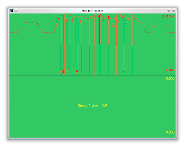

Hello forum, I have a problem with noise on my analog lines and I was wondering if anyone had any quick and dirty ideas I could play with. Here is a quick description of what I 'm trying to do.
I have a DC-SS009 3-axis accelerometer which spits out an analog signal which can be read through the Arduino's ADC. I thought I 'd mount it on a platform that is allowed to rotate along one axis and stick two motors with propellers on either end to balance it at a given angle. The whole setup can be seen below.

The picture below shows the final angle readings I get after processing the ADC voltages. This is the range of motion I have physically allowed the platform and the resolution is not that bad within it. These readings have been taken with the motors off and me moving the platform with my hand. It is sketched in a silly little Processing sketch I have written to act as a crude scope.
The next one shows the same thing (me moving the platform around within its limits of motion) but with the motors on. The noise is beyond terrible.
This one shows the transition to quiet as I turn the motors off. The difference is obvious.
Now, the big question is, where does the noise come from? If it's kicked back down the motors' power supply line and somehow manages to travel through the L293 and up the Arduino's digital output pins there's not much more I can think of doing other than stuffing ever bigger capacitors on the motor power supply line. However, I thought I could be picking up electromagnetic noise through the unshielded lines going to the ADC acting as aerials. I 'm sure the motors must be spitting out some pretty disgusting EM fields around them as they go about their business and the ADC line is just begging to pick it up.
To test this, I disconnected the digital output pins from the L293, completely isolating the Arduino from the motor power supply lines (they still share a ground). I then connected the motors directly to the battery and turned them on and off. The results are shown below. I was quite astonished at what a tremendous amount of noise my unshielded line is picking up (I am also astonished that the platform actually manages to kind of balance, although in a very drunk manner).

I think your noise problem may be vibrations induced by the motors.  Perhaps filtering the signal would help reduce the noise.

Vibrations!
I simply removed the accelerometer board from the platform and held it in my hand a few millimetres above its position and my "noise" disappeared.
