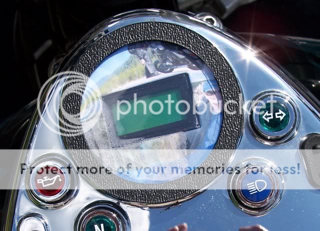

You may have seen my project in your googling http://arduino.cc/forum/index.php/topic,8474.0.html - I'm still playing with it.
I'll give you a few random thoughts:
  • Packaging the LCD to be waterproof proved to be too difficult for me - i'm still looking for a solution
  • I ended up using a simple set of LEDs in a homebrew bar-mount because they were easy to waterproof
  • Hardening the arduino power supply to survive the bike's 12V environment is a significant challenge
  • I did not attempt to combine everything in one package because all my sensor access points were in a tank mounted console and i wanted my display on the bars
  • Each input you want to deal with at 12V means several components to protect the arduino and more leads to connect so if some things are ready to drive LEDs or idiot lights on their own I would just do it that way
  • One of the good decisions I made was to make sure I had serial access to the cpu for debugging and reprogramming.  I also hooked up a bluetooth module to get in-flight data
Pics below: Failed waterproof LCD enclosure; Bicycle speedo as a waterproof display; Bar mounted LEDs.
Also, here's a fellow using a Nokia tablet for his display and a ram-mount box to protect it.http://forum.sparkfun.com/viewtopic.php?p=80410#80410
Good luck and keep posting!  I actually have several of the prototypes around and if a circuit or the physical board would be a big help, PM me.

Thanks Bill, your thread was one of may I read about. If you haven't been able to waterproof the LCD, that's bad news for me. The box I'm looking at is here:
It looks like there is a casting mark in the center, which would not do much for the use of the LCD behind it.

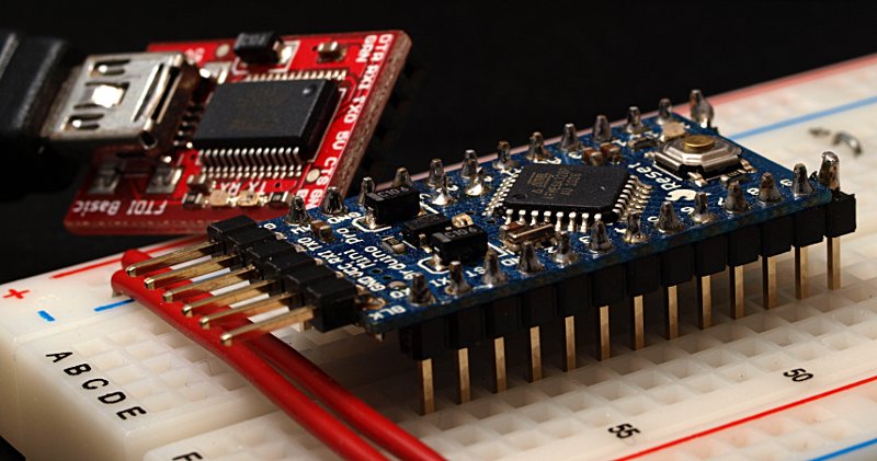

For your needs, I would suggest either the Pro Mini together with a FTDI USB-Breakout cable or FTDI USB Breakout board or the Arduino Nano. Those have the smallest form factor and don't have any connectors soldered on. Those are best for use on your motorbike. To use the Pro Mini with the breakout board, just solder pins to the serial and you're ready to go. My development kit with the Pro Mini looks like this:
About the starter kits, I would forgo those, as you have a very clear project in mind. Just get the parts you need, a breadboard and your usual collection of resistors, LED buttons etc. But I guess, you have those anyway. In this project, as written above, the real challenge is the electrical part to get stable and clean power and the enclosure.
