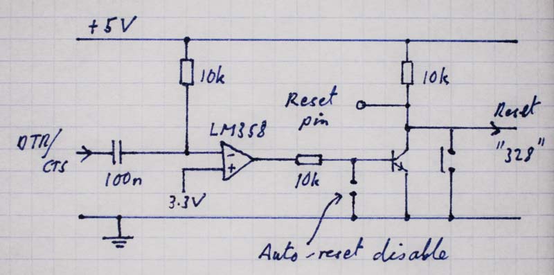

Could someone describe the diode fix, can someone participating sum up?
Wiring a diode from the reset pin to +5vdc (cathode lead to +5v) clamps any voltage higher then +5vdc going to the reset pin. This prevents the +10vdc pulse from the auto-reset cap from causing the problem stated in this thread. It's treating the symptom rather then the cause, but is simple and effective.
I just came across this thread after acquiring an Uno R2.  The coupling capacitor used for the auto-reset feature kind of bugs me:  disabling auto-reset (as required by certain applications) involves overloading - albeit briefly - the the pin on the ATmega8U2.  As does the proposed diode-clamp.
This situation calls for a proper solution.  Switching the reset pin via a transistor entails no risk of voltage spikes, doesn't impede high-voltage programming, and can be disabled with a simple short.  Excuse the scribble:
The disadvantage is that the logic of the auto-reset signal is inverted (high -> reset).  Of course this can be corrected in the 8U2 firmware, but it's not a solution for boards which use external serial interfaces.  These boards could use a second transistor to invert the auto-reset signal.  Any thoughts?

For auto-reset to work correctly, it has to cause a reset pulse only during the transition of the signal from the 8u.  that's because the host side software doesn't "toggle" the pin, it just changes the state as a result of "opening" the virtual serial port.  If  you're willing to make the host-side software specifically arduino-aware, you can just connect the 8u pin direction to the 328 reset pin, and use some other SW mechanism to create the reset pulse...

Ah, good point Westfw.  Ok, here's another version.  This one requires no modification of the 8U2 soft, and is also compatible with other commonly used serial interfaces.
It uses 3 extra components over the current version of the Uno: two 10k resistors and a transistor.  The other components are already available at suitable positions on the board, including the op-amp.  The reset pulsing remains exactly as on the Uno-R2, but the LM358 can withstand any over-voltage glitches applied to its input.  The transistor allows external signals to be applied to the Reset pin without risk of damage.
-Tim
