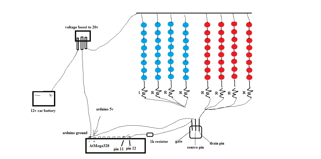

Hi guys,
I am building a police light set up (wait wait, I know, but this is only for my self for demo purposes and to use for offroad use). This will be a simple set up:
2 pods in the back window: each has 12 blue leds (two rows of 6) and 12 red leds (2 rows of 6)
4 pods in the grill each consisting of 4 leds: two blue and two red pods
Totaling 64 leds. I will be using 3mm piranha leds from superbrightleds.
So far I have built one pod ( 24 leds) on a breadboard where each pin connects to two leds (I figured that's at most what it can handle from each pin as its rated up to 40ma)
At this point I am not sure how to proceed to connect the rest 40 leds and make them work together. I have a mega which will easily accommodate this, but don't want to waste it. Or I can build another clone using atmega 328 to use for the other pod(s).
should I use Charlieplexing? Is this the easiest way to accomplish my task? That way I can use just one board?
This will be connected to the car. I have searched topics on connecting it to the car and have gotten a few diff ways to do it.
Therefore I am wondering, if I tap into the radio or perhaps some other source will it be enough to power my 64 leds?
What is the easiest and safest way to connect my clone or uno/mega to my car to have it work?
Thanks,
Roman

That's pretty straightforward.
Arrange your LEDs in strings of 8 LEDs connected in series with a current limit resistor, 4 strings per color.
Each string will require <=20 mA from a 16-20V source.  Wire the 4 strings in parallel.
Obtain a DC upconverter from pololu.com such as this
http://www.pololu.com/catalog/product/799
to convert the car's 12-14V up to the 20V or as needed for your particular LEDs.
Then a single NPN or MOSFET transistor such as IRF3707Z can be driven by the arduino to turn each LED collection on & off.

Thanks guys for the replies
CrossRoads,
i made a diagram of what i understand it to be. However i tried searching for the IRF3707Z or 7406 ic but to no avail. Please point me in the right direction. is it also availbale from pololu? so i can order everything at once? I tried radioshack and the like and none have IRF3707Z.
I want this done before new years so i will overnight parts however i dont know what to order.
red leds are rated at 20mA and 2.0v
blue leds are at 20mA and 3.3v or so.
which resistors do i need?
I used online calculator and for the blue i got 390 ohm resistor if wired by 4 in series with 8 rows
and for red i got 220ohm if using like u suggested
Thanks for any tips i really appreciate it

Ok Roman, that is a shame, I bought 10 of those a while ago & now can't find them anywhere.
I searched at mouser.com, and found this part that will do nicely instead.
http://se.mouser.com/ProductDetail/NXP-Semiconductors/PSMN035-150P127/?qs=sGAEpiMZZMvKM5ialpXrmoKPBF94BAPg
Your schematic is not quite correct.
Make sure to connect up like I have shown - 20V is the top of LEDs in series, finish with the resister going to the Drain pin of the MOSFET, with the Source pin to ground. With this  MOSFET you are opening & closing the circuit on the Ground side, and not on the high voltage side.
Connect the Arduino pin to the gate thru a 1K resistor, with a 10K to ground.
Mouser also has 7406's in stock
http://se.mouser.com/ProductDetail/Texas-Instruments/SN7406N/?qs=sGAEpiMZZMtYFXwiBRPs0wQlaYsWIJgx
Your resister choices look okay.

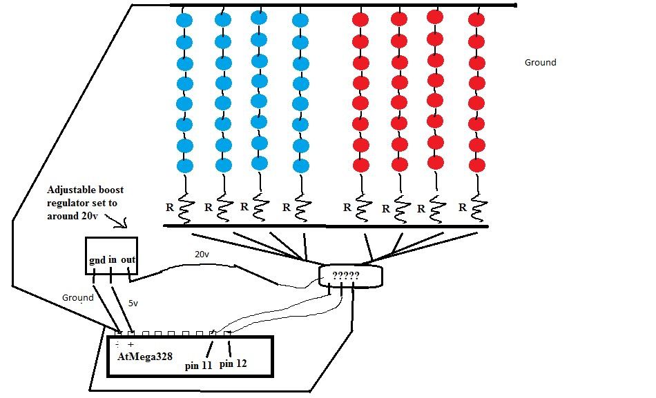

Hi CrossRoads,
sorry to bother again but i am stomped.
I have received all the parts and i am lost as to how to properly connect everything.
I ordered 2 mosfets transistors, 3 7406s and not sure which is better to use and finally got the voltage booster.
Please help me with a sketch. I dont understand how do i connect the second part of leds (blue ones, according to the sketch) if it only has 3 pins.
Please help i would love to finish this by the end of the week if possible.
any suggestions are appreciated
Thanks a bunch
Roman
Here is the current one i just cant understand how to finish it.

You are oh so close! Just needed to show the 2nd driver:
sketch would be simple - I didn't compile this, just writing from scratch, should be pretty close

Sorry Roman, was out of the house tonight.
What Mosfet do you have?
PSMN035?
Middle pin is the drain where the resistors meet up.
The riight hand pin is the Source, which goes to 9V-/ground.
Sounds like you have them swapped.
You are running the sketch I drafted? If so pin 10 is an input with an internal pullup resistor.
You can fake it being a switch by connecting/disconnecting to ground.
Disconnected, it is 'open' and the LEDs shouldbe off.
Connected to ground, it is 'closed' and the LEDs should blink on & off.
Logged

CrossRoads,
Thank you so much sir. I finally figured it out and able to do it thanks to you. Exactly how i wanted it. Thank you 10000 times. smiley
