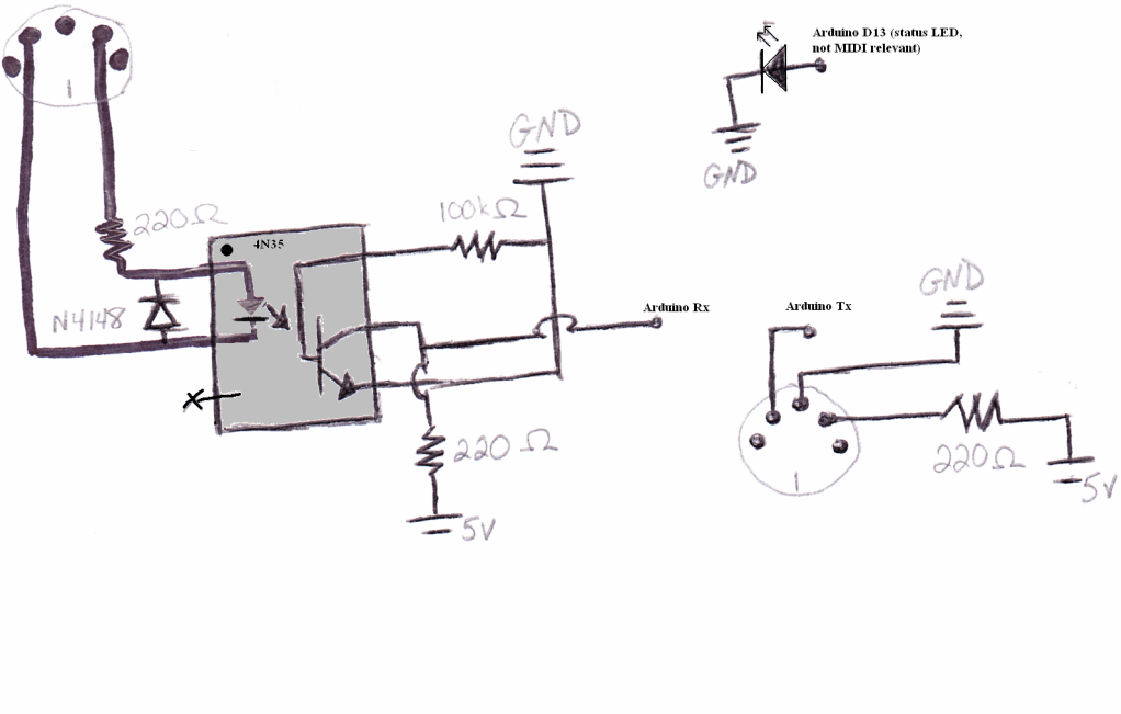

I'm trying to make an Arduino circuit to accept signals from a midi source (in this case a midi keyboard) and pass (most of) them back out for a little pet project.
The order of devices goes:
keyboard -> Arduino -> commercial midi to USB converter
I'm using kuk's midi-in circuit from here, hooked to the Rx pin of my Arduino Uno.
The midi out is coming from my Uno's Tx pin.
Now, my problem is... When monitoring the midi signals coming in from the midi to USB converter on my wife's Mac (using a program called MIDI monitor), it seems to be dropping signals. It will only register a set of note on/note off commands every 4 seconds or so. If I go any faster than that, the monitor doesn't even see the command. But clock signals and active sense signals seem to stream in no problem.
I am really at a loss here. My baud rate is 31250 as per the spec. At first I thought my optocoupler was too slow (4n28) so I bought 3 other kinds and they all have the same behavior, even though running them through a test circuit verified that the optocoupler itself was working correctly. Then I thought the Arduino MIDI library I was using was flawed, so I tried using straight serial writing. Now I am reading about how the Arduino introduces some serial latency, and I am worried that it means the Arduino Uno is too slow to do what I want to do.
Any help at all would be appreciated. I can show you the code I am using, I can (try to) show my circuit(s), I can show you the whole setup from keyboard to converter. Just... somebody please help me before I go crazy!

OK, show us everything :)   One thing I noticed from the schematic you reference is that the 3.3k resistor is too high. It needs to be about 10 times smaller (330 ohms or so) else the rising and falling edges will be too slow.
We've got a Flexible MIDI Shield product that might simplify your life a little bit (and clean up your wiring). If you look on that page there is also some sample code that works for sure (on a Mac even!). There is really no reason for a 4 second delay....

Ultimately, the point is, if the keyboard sends a note (on or off), send the note through to the midi out. Any other signal, trap it and send out a pitch bend signal, with the pitch bend value being read from an analog input.
Well that certainly made my ears prick up... Too slow? I don't have a 330 ohm resistor, but I have 220s and 100s to put in series. Close enough, right?
Beat707: MIDI drum machine / sequencer / groove-box for Arduino
I would really like to avoid buying a shield for MIDI if possible. I mean, kinda the point of this project was to do it myself... Just a stubbornness I have. But thank you for the suggestion. If push comes to shove, and a head of hair turns into fistfuls of it, I'll definitely keep your shield in mind. Thank you for your help so far.

RuggedCircuits
Quote
Right. You could even just use a 220 by itself.
The code is....a bit overwhelming :)  I don't know where to start looking for issues. It would be best to trim things down to as simple a sketch as possible and see if the problem is hardware or software.

RuggedCircuits
Quote
is there a preferred method for showing one's schematic/circuit?
It would be best to indeed post a *schematic*, not a wiring diagram or a picture of your breadboard. It's very hard to figure out what your design intentions are from those. The original 4N28 circuit you referenced was pretty close to a schematic (it would have been better if it showed the internal LED and transistor). Take a look at the schematic of the shield I mentioned (or any other Arduino shield for that matter) and see if you can sketch something similar on paper.
Then start learning Eagle :)

This is my midi in and my midi out (assuming I drew it all correctly and followed my circuit exactly). The second batch of code calls for pin 5 of the 4N35 to be ultimately hooked to D10 of the Arduino, so that's where it goes when I work with that code.
*edit* Whoops. Forgot the pin 1 indicator on the 4N35

Also, putting the 220 Ohm resistor in place of the 3.3k as suggested got me NOTHING coming in, so I went back to the 3.3k.

[Also, putting the 220 Ohm resistor in place of the 3.3k as suggested got me NOTHING coming in, so I went back to the 3.3k.
Now that's interesting. Makes me think the 4N28 is not the right opto here, or you need to play with that resistor. 220 may indeed be too small for the 4N28 yet 3.3k too high. I think it's worth trying something in the middle.

Well, I had to ditch the 4n28 because it failed the opto test circuit found here. I guess it went bad or something. Using a 4N35 instead because after the 28 failed I went back to the parts store (no returns! all sales final!) and said "Ok, give me one of every optocoupler you've got." Happened to test the 35 first, it passed, so I stuck it in the circuit. Pinout's the same. Can't see too much difference in the properties of it but admittedly, I am pretty noob-y with this stuff. As if that wasn't already obvious! Anyway, datasheets for each:
4N28:
http://www.datasheetcatalog.com/datasheets_pdf/4/N/2/8/4N28.shtml
4N35:
http://pdf1.alldatasheet.com/datasheet-pdf/view/2848/MOTOROLA/4N35.html
If you could take a look and see if I am underestimating the differences, I would appreciate that.
In the meantime, I am going to monkey around with the other resistors I have on hand to see if I can find a combination that puts me in a "sweet spot"
