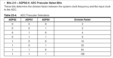

According to the specs:
Quote
By default, the successive approximation circuitry requires an input clock frequency [ADC clock] between 50 kHz and 200 kHz to get maximum resolution. If a lower resolution than 10 bits is needed, the input clock frequency to the ADC can be higher than 200 kHz to get a higher sample rate.
The ADC clock is 16 MHz divided by a prescale factor. The prescale is set to 128 (16MHz/128 = 125 KHz) in wiring.c. Since a conversion takes 13 ADC clocks, the sample rate is about 125KHz/13 or 9600 Hz.
So anyway, setting the prescale to, say, 16, would give a sample rate of 77 KHz. Not sure what kind of resolution you would get though!

// set prescale to 16
sbi(ADCSRA,ADPS2) ;
cbi(ADCSRA,ADPS1) ;
cbi(ADCSRA,ADPS0) ;

So if I just include your defines in the top of my code and the function calls in my setup, I should be good to go?  As in, analogReads will just return a lot faster (at a bit lower precision)?
How exactly is your code setting it to a prescale of 16.  I don't see any numbers in there..

As for how the above code relates to a prescale value of 16, that's from a table in the Atmega data sheet:
