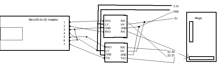

Hi All,
I've got a pretty weird problem. I'm trying to interface to a microSD card using two of sparkfun's logic level changers: http://www.sparkfun.com/products/8745
I've got them set up like this:
Please excuse the horrid circuit diagram.
I've eliminated most of the obvious failure modes; drawing too much power from the arduino's 3.3v (powered it independantly from a 3.3v rail on an ATX PSU), pins plugged into the wrong place (checked four or five times) and basic electrical faults (half an hour with a multimeter). I've tried two different microSD cards that have been independantly verified as being A-OK, neither are kingston branded, and both were FAT32. I'm connecting to the microSD card via an SD-to-microSD adaptor. The adaptor works, I've measured all connections from the pads on the card.
I'm using the bog-standard SD card test sketch that comes with arduino 22. I'm using a 2560, the uno mega.
Any ideas?

The resistor level shifters in this product don't work well with SD cards.  The two 10k resistors result in 2.5 V on RX .
http://www.sparkfun.com/datasheets/BreakoutBoards/Level-Converter-v10.pdf
In general resistor level shifters are not recommended for use with SD cards.  The SD spec requires a maximum rise time of 10 ns for SPI signals.  Resistor level shifters often produce sort of a sawtooth SPI signal.

The problem was that I had my TX and RX lines backwards. T
I figured that out after I replaced it with a 74HC4050 circuit.
