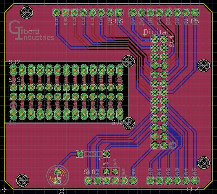

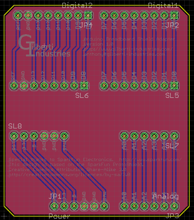

Hello there.  I'm currently developing a very simple Arduino accessory but could use a little help.  In particular, I'm looking to see if there is even any interest in such a product.
There is no denying that the Arduino's use of shields is one of it's strong selling points.  It allows someone to spend less time on the electronics and their physical assembly and get right down to tying everything together with software.  I, however, am not in a position in which I can jump on the shield bandwagon.  My first, and currently only, Arduino clone is the RBBB, a solderless breadboard compatible clone.  It does not work with shields.  So I thought to myself as to how I could remedy this problem.  The solution is a PCB that adapts the shield profile to a solderless breadboard.  Such a prototyping tool could facilitate 3 things.
1. It allows a person with a breadboard-compatible, shield-incompatible Arduino clone to experiment with shields.
2. It allows a person who uses other microcontrollers like the Basic Stamp, PIC, or one of a hundred others to experiment with shields.
3. If, instead of soldering pins to the bottom for the breadboard and sockets to the top for the shield(s), you solder pins to the top for the breadboard and pins to the bottom for an Arduino, you can use the adapter to connect a shield-compatible Arduino to a large breadboard.
As you can see, I already have a PCB designed.  It was extremely easy.  I just took the files for the SparkFun ProtoShield, removed the prototyping area and all the electronic components, and trimmed down the PCB.
I've crunched the numbers.  The board measures 1.85x2.10 inches.  My normal supplier of PCBs, Gold Phoenix, will sell me 39 boards, with electrical testing and ROHS compliance for about $4.11 per board.  Buying enough sockets for all 39 boards comes out to $1.44 per kit, and 56 pins per board comes out to $2.21 per kit.  Each unassembled, unshipped and unpackaged kit would cost $7.76.  That feels a little high, especially considering the ProtoShield the adapter is based on is $15.
Parts per kit:
S7004-ND 6 position socket x2 ($0.31270 at 100)
S7006-ND 8 position socket x2 ($0.39410 at 100)
A26509-40-ND 40 pin break away header x1.4 ($1.57200 at 10)
Gold Phoenix fabricated board, 2 layer, 1.85x2.10 inch, electrical testing and ROHS compliance x1 ($4.11)
What I am trying to get at is this:
1. Is there even a demand for such an accessory?  If you do want such a device, would you buy my kit, make your own, or modify a prototype shield kit?
2. Do you have any suggestions to make the kit cheaper?  I was hoping to make it $5, add no more than $3 for my labor and such, and ask that the purchaser pay for shipping.
Before you ask, this is not my first rodeo.  For a time I was building ArduinoBoys and selling them to the chipmusic community.  I managed to sell 68 of them before I decided to call it quits.

I like the idea as it solves a problem, however it introduces a new problem too IMHO. Shields are relative "BIG", sometimes as width as some breadboards, so this design could cover all the holes of the breadboard, or at least a substantial part. A better design needs to be able to connect to a breadboard, without covering it. So here my thoughts:
* Imagine a PCB in which you can plug a shield (you made that working allready). However the PCB does not plug into the breadboard but has header pins so I can connect it with standard female/male cables to a breadboard or to an Arduino or to some other thingy. That gives the freedom searched for I think. The cable can be some flatcable or so.
[in fact I used a screwshield - http://www.sparkfun.com/products/9729 - this way.
* The PCB should have 4 mounting holes so it can be used in permanent setting
* The PCB should have a LED to show that the +5V is applied to it.
* The PCB shield could have a separate power connector (solderpoints for a jack like the Arduino?)
Question
* Why are the GND's not connected in your design?
Its funny that this discussion should come up, and in fact that these very details would be in your suggestions, as, as soon as this weekend I was preparing to release just such a board.

Nice cidekick Boz,
it can connect shields to a BB without the Arduino underneath and without covering the BB.
Good idea to connect the GND rail to the GND pin of the shield, however, for the 5V I would prefer to keep them separated (or better, switchable) so I can have a separate power supply for the BB 5V line. The GND's connected is needed for signalling from shield to BB and back. Maybe the Cidekick 2.0 could have a power connector so it can supply the BB?
Furthermore I would prefer a one piece shield above the two pieces connected with flatcable because of stability.  Maybe add connectors (holes) on the back for RS32 & I2C & SPI pins?
Question
Thanks for the suggestions.  Two PCBs, one for the breadboard, the other for the shield(s), connected via ribbon cable.  Doable, but perhaps a bit more expensive.  I can see how an LED and a dedicated power supply could be useful, and I could include them in the layout, but I'm not so sure I would include those parts in the kit.  Maybe.  Oh, and the ground pins are connected.  It is called a ground plane.  All the excess copper on the board is connected to ground.
Let me get back to you on this.  I think I have a great idea.

Please note that it is not done.  There are still some labels to place and I'm starting to warm up to robtillaart's idea of adding a 5V supply.
The inside of the board is supposed to be cut out with a coping saw to form the breadboard adapter.  It would be wasted PCB material otherwise.  The two boards are then connected by a 26 conductor ribbon cable.
The holes are supposed to line up with the holes on a shield, just in case someone wanted to use the adapter in a more permanent setting.  The kit would also include four adhesive rubber feet to stick to the bottom of the shield adapter board.
Thoughts?  Concerns?  Complements?  Complaints?
