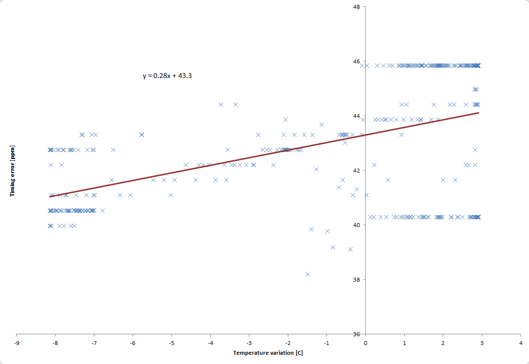

    ...and here's the same test with a crystal-clocked Arduino-clone.  I used a Freetronics "Eleven" board, which is very similar to the Uno I used in the previous test.
    The results are within tolerances quoted for typical crystals.  Compared to the resonator-clock:
  • the average error is 43ppm, 47x better
  • the temperature stability is approximately 0.28ppm/C, 35x better
For context 1 minute per year is about 2ppm.
The average frequency stability over 25 hours was better than the measurement error, which was 0.6ppm.  This implies that, unless the temperature is controlled to within about +/-1C, long-term stability is determined by temperature variations.

Quote
That surprised me a little bit. Most crystals are 1ppm/c, and 20ppm initial so unless yours was exposed to 20c+/- variations it is hard to produce that kind of drift.
I have some Epson (regular, non TCXO) oscillators that are rated 50ppm. I tested about 10 of them and their initial accuracy is within 5ppm and practically 0ppm/c.

Quote
Hi Dhenry,
I think you're mixing up frequency stability and average error.  I measured a variation of approximately 0.28ppm/C, which is well within spec.  Average tolerances of +/-50ppm are common, so an average error of 43ppm is reasonable.
