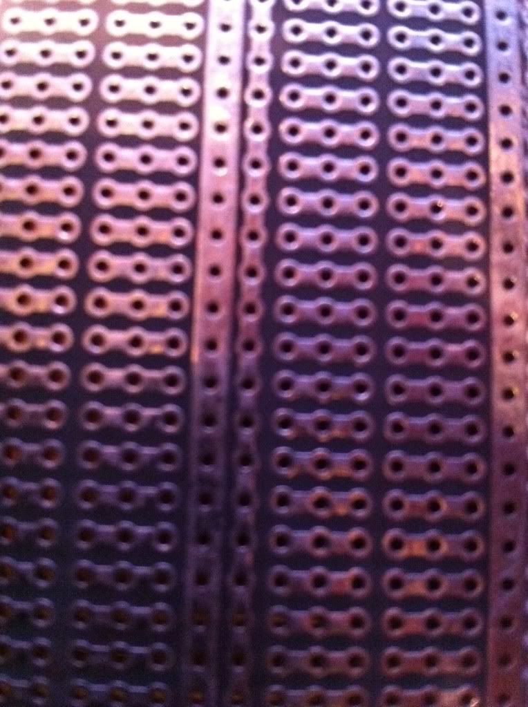

Hi guy's,
I would like to add some patch area to a design of mine like so :
Anyone help with how to do this in eagle?
TIA,
Texy

Add connectors.
Search for ma03-1, mao3-2, ma04-1, mao4-2 for 3 and 4 hole examples.

Thank Bob. I found m03, etc, which is close, but I can't find ma0 (yet)..........

It's there, I use them all the time for shield headers & jumper fields.
When you select Edit:Add, search for ma*, they should show up.
When I get home I can tell you the specific library they are in.
If you open Edit:Add and select no library, then type ma03-1 in the bottom, it should pull that one up.

This is the library
con-lstb
device: MA03-1
type in mao*, shows a whole list of options from ma03-1 to ma09-2
I use ma03-1, 04-1, 06-1, 08-1 a lot and -2's when I want a 2nd row for grounds.
