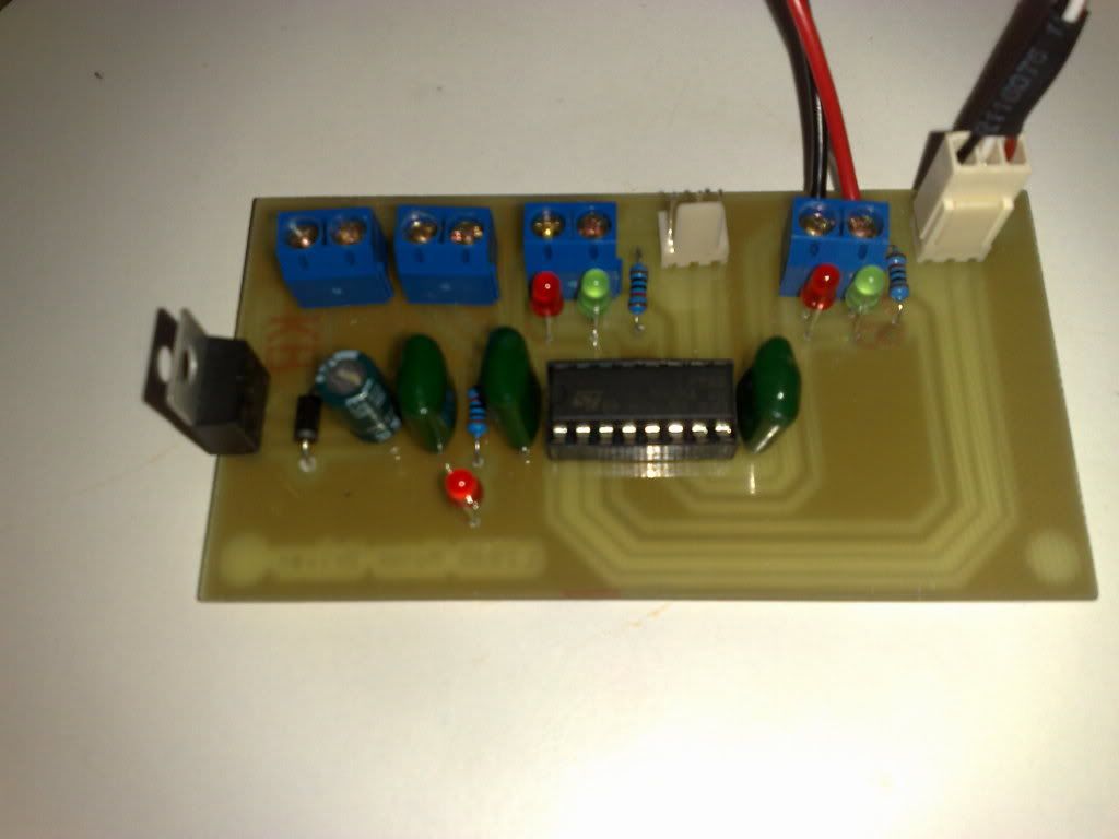

The L293 datasheet says external clamp diodes are required for inductive loads...
Datasheet states that it has internal clamp diodes.
I have tested the voltage levels on the pins today and I seems to me there is something wrong with the regulator. Because for a 5V regulator its output is about 6.11V without any loads. I have to replace it with a new one and I will let you know about the progress,
update: I just did a voltage test on IC pins and found out that VCC2 has 2.8V across its terminals with 5V logic supply signal inputs connected to the board. I am clueless... smiley-roll

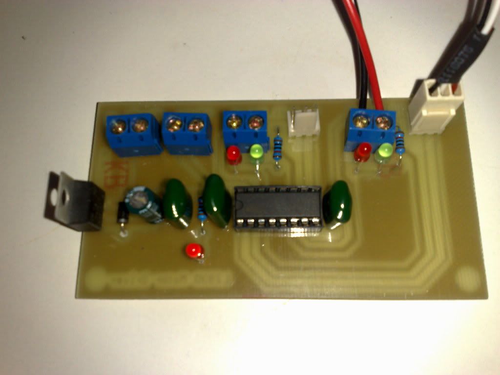

The L293D is plugged in backwards.  Look at the notch orientation on the board file (to the right) and look at it on your board (to the left).

How can be so blind   smiley-red, I would like to apologize from all the forum members who has contributed to this topic. I think I finally know what happened. I did the layout for this board and gave it to one of my good friends to develop it, he said he has altered the design a bit and I really thought that the IC was is in its original position. Well, really sorry guys, and thank you all for your valuable contribution.  smiley
