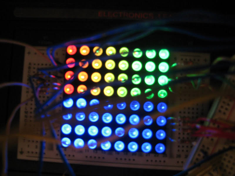

Some decent progress made tonight, should easily finish tomorrow assuming I haven't screwed something up.
To answer your questions though:
Let me preface with : I'm a complete noob, this is my 2nd project and am learning as I go.
I'm using an RGB 8x8 common anode matrix from LedSee (only $10 on ebay). I agree I think the matrices available out there are way overpriced at $35++ and then you have another $30 for the driver boards. And what's the point? For me I wouldn't have learned much from using those.
I've already roughed this up in a prototype which you can see here:
I was able to get fading implemented using some code from this guy:
http://blog.spitzenpfeil.org/wordpress/page/2/
Basically I'm building the same project as him only he knew what he was doing. It's fun though and I'm learning a lot.
The reason for the layout is to try to squeeze everything underneath a single matrix (6cm X 6cm). One of the shift registers will be on the outside but no biggie. As will the arduino.
Here's a snap of the PWM working in mockup.
more tomorrow probably.

Robert, thanks for the help so far. You may recall on Youtube I commented that I couldn't light more than one color in a given LED at a time. The ISR code was a great help to me and the fact that you got everything working made me realise it was possible and that I had something wrong in my wiring. It turned out to be that I was not accounting for RED's forward voltage being lower than green and blue in the matrix, hence RED was always on and at a specific voltage green would turn on, as opposed to and even fade from red to green. I've accounted for this with 330 and 220 ohms resistors which seem to be a good match.

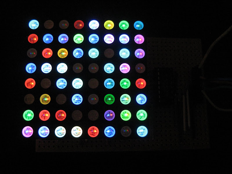

well I got it working after clearing up a few shorts. I must say it looks great but very hard to photograph or video tape.
Here's a link to the finished product.
and the gallery is here:
http://picasaweb.google.com/francisshanahan/20090104ArduinoLedMatrix
Next step will be to make a nice enclosure and program a few cool animations.
I've tried linking to it interactively from Processing but seems like the refresh rate is pretty slow. Any idea what the quickest way to send down 3x64 bytes of data would be?
