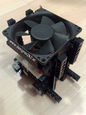

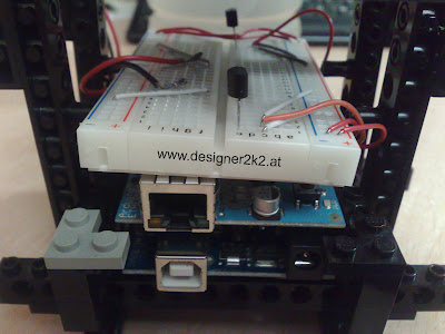

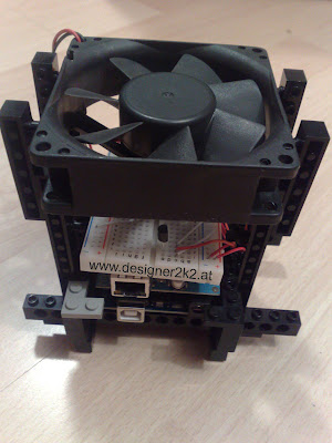

Hello,
the Temperature in my "Workroom": (its in °C, over the last 24h)
or combined: http://www.designer2k2.at/pachube.php
the Hardware:
its a Arduino Duemilanove + a Ethernet shield + small Breadboard + 80mm PC Fan (running at only 5V) + Lego
the Fan is running at 5V, so very slow, but enough to get the LM35´s very precise  smiley
i calibratet the LM35´s with a thermocouple (about 1,4°C error on both)
here both sensors can be seen idividual: http://www.pachube.com/feeds/1761/
on the Arduino im running the "Pachube code" nothing special there...
the Charts are drawn with the Google Chart Api, nice stuff  smiley-wink
im Powering this thing with a USB MP3 Charger, couldnt finde a cheaper and easier powersource  :smiley
maybe later i will replace the breadboard with a small print, but thats so much work, compared to the breadboard  smiley-razz
