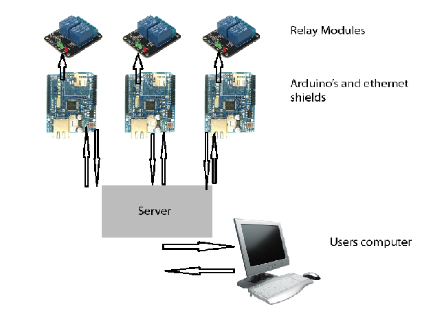

hey there all,
I want to control a bunch of relays with an arduino over the internet via an Ethernet shield, however I need the arduino set up as a client connecting to an external server since there will be more then one arduino. This is where I'm stuck what do I need on the server side (php scripts, sql databases, etc...). what I would like to know and need some help with is the code to send/ receive information to/from the server (Arduino side)and all the server side code. Any information regarding this would be very helpful and would be much appreciated
thanks PhayilBoy

It is not clear what you want to do.
Quote
This is clear. The Arduino will act as a server, serving up a web page with a form that allows any client to submit the page. The Arduino as server will then parse the submitted data and make the appropriate changes.
Quote
This is not. If you have more than one Arduino, you need more than one Ethernet shield and more than one port, since each Arduino server needs its own port.
If you expect to have a server somewhere that clients can send submit requests to, then separately, the Arduinos as clients would access the data, using different scripts, and do stuff.
There is no way to have a web server push data to the Arduinos, if the Arduino is a client.
Quote
Exactly the same "stuff" as you would need for any other client to access the data. There is nothing Arduino-specific in what you want to do.
Some pictures might make what you want to do clearer.

So what I wanted was a single webpage hosted on a server that has a bunch of radio buttons(or just buttons) that the user can access, so they can turn on or off the relays connected to the arduinos. The arduinos would be connected to the server through there own ethernet shields and control the relays depending on what the user has clicked on the webpage. (I hope that made sense).

So, the only thing common between the client/server relationship involving the PC and the client/server relationship involving the Arduinos is the server and the data store.
There does not appear to be anything difficult about your project. You need to set up a server and have it server up a page to the PC client. The page will have a form with a submit button. The submit action will send a GET request back to the same server, with additional data in the request.
The server will parse the request, and store the data somewhere.
The Arduino clients will make similar GET requests (not identical) to learn what to do.

Thanks paulS,
Quote
when you say store the data somewhere, will I need an sql database to store the data?

Quote
That is entirely up to you. I have no idea how much data you are talking about, how often it will change, how many PC clients you expect, or how many Arduinos you have. I have no idea how you will segregate the data for one Arduino from that for another.
The project seems to barely involve the Arduinos. Most of your questions are completely unrelated to Arduino (not uninteresting, not stupid by any means, just unrelated).
