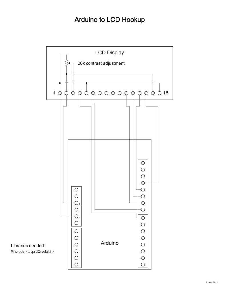

Here's a drawing to get you started:

The original question was about turning the LED backlight on and off so all the discussion about the contrast adjustment is interesting but irrelevant, as is the wiring diagram.
Your display does not need an external current limiting resistor for the backlight but since the current is 145mA you will need a transistor to control the backlight with your Arduino.  Any garden variety NPN transistor will work, such as a 2N3904 or 2N2222.  Connect the backlight pin 15 (LED Anode) to +5 V and backlight pin 16 (LED Cathode) to the transistor collector.  Connect the transistor emitter to GND.  Connect the Arduino output pin through a 330 ohm resistor to the transistor base.

The drawing depicts the REQUIREMENTS of the LCD display, and is 100 percent accurate.  As drawn, the backlight will be on all the time.  It was a drawing from a project I did a while ago, and I documented it for future reference.
However, if you want to switch the LED on and off, the transistor requirement is mentioned in the 1st and 2nd reply on this thread.
