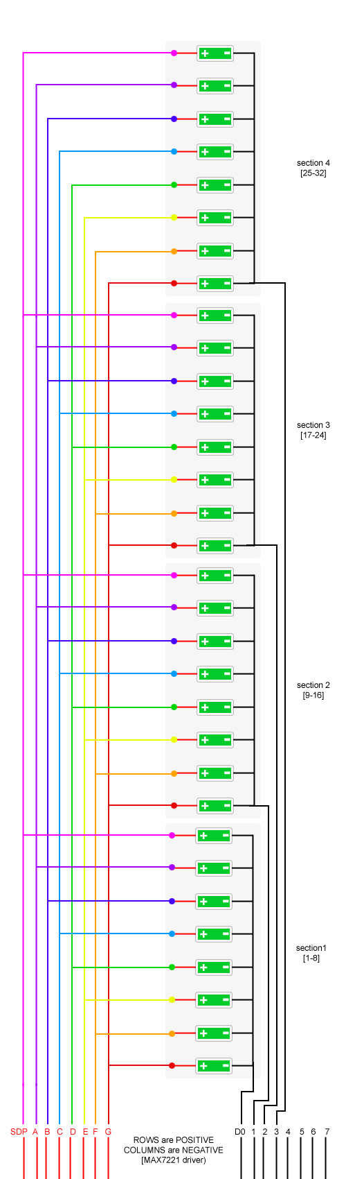

ok.. (back on this topic for me)  =)
I have my free samples from Maxim MAX7221 chip..
I do NOT want a 'cube' layout of my leds.. but more of an addressable LED strip..  (I think thats correct terminology?..yes?)
I think I originally had the 'orders' of leds wrong.. (meaning each 'section' of '8' leds went (from bottom to top) 8, 7, 6, 5, 4, 3, 2, 1...etc)
I switched just befor eposting this..  (thinking it was wrong) and needed each one to go from 1-8 in that order..
but I havent begun to mess with the software or any libraries for this..etc, so Im not clear/cure if there is a preferred order that helps when using the libraries/classes?
I 'think' Im only going to be using 4 sections of 8 leds (4x8 matrix?)
anyways here are both versions.. is there a preferred way to wire that may make it easier to follow/understand when doing shitOut() function/calls?..etc?
sorry for the long images..want to sketch it out in my head for the led strip visual.
Also I saw shiftPWM().. can this be used as well? instead of just plain shiftOut() off/on type?  (thinking a smoother larson scanner effect..etc) thanks
Logged

With the MAX7221, you use SPI.transfer to write to each register that represents 8 LEDs.
There a couple of registers to write to start up - scan limit (how many digits), intensity (brightness), mode of operation.
// addresses for the MAX7221, and the values/ranges to write in
#define DECODE_MODE 0x09 // write data 0xFF, Code B Decode for all digits
#define INTENSITY_ADDRESS 0x0A // 0x07 to start, half intensity. valid from 0x00 (min) to 0x0F (max)
#define SCANLIMIT_ADDRESS 0x0B // 0xFF, all 8 digits on
#define SHUTDOWN_ADDRESS 0x0C  // 0x01, normal operation (0x01 = shutdown) - powers up in shutdown mode
#define DISPLAYTEST_ADDRESS 0x0F // 0x01 = all lights on full, 0x00 = normal ops
Do 2 SPI.transfer's with register address and the data you want.
Heres the transfer for one of the 8 display registers.
  digitalWrite(SS,LOW);  // take the SS pin low to select the chip
  SPI.transfer(minutes_tens_address);  // select the Address, (I had 8 digits,wrote to them all like this
  SPI.transfer(number_to_display);      // select the data
  digitalWrite(SS,HIGH);   // take the SS pin high to de-select the chip
Don't need any library for this.
Logged

Yikes!..
lol..  thats alot to digest (never played with SPI interface before... not the MAX7221 driver chip)..
I am still working on the physical/wiring of it all (in my head)..
so I can understand how to get it working with an led type layout for the matrix wiring..
is there a difference or benefit between the two diagram proposed?
And also 'are there' any libraries made for the MAX7221 chip for easy interfacing? (methods/functions to use) just curious.
I'll take a look at the code samples you provided when I get the actual code/testing part.
thanks
