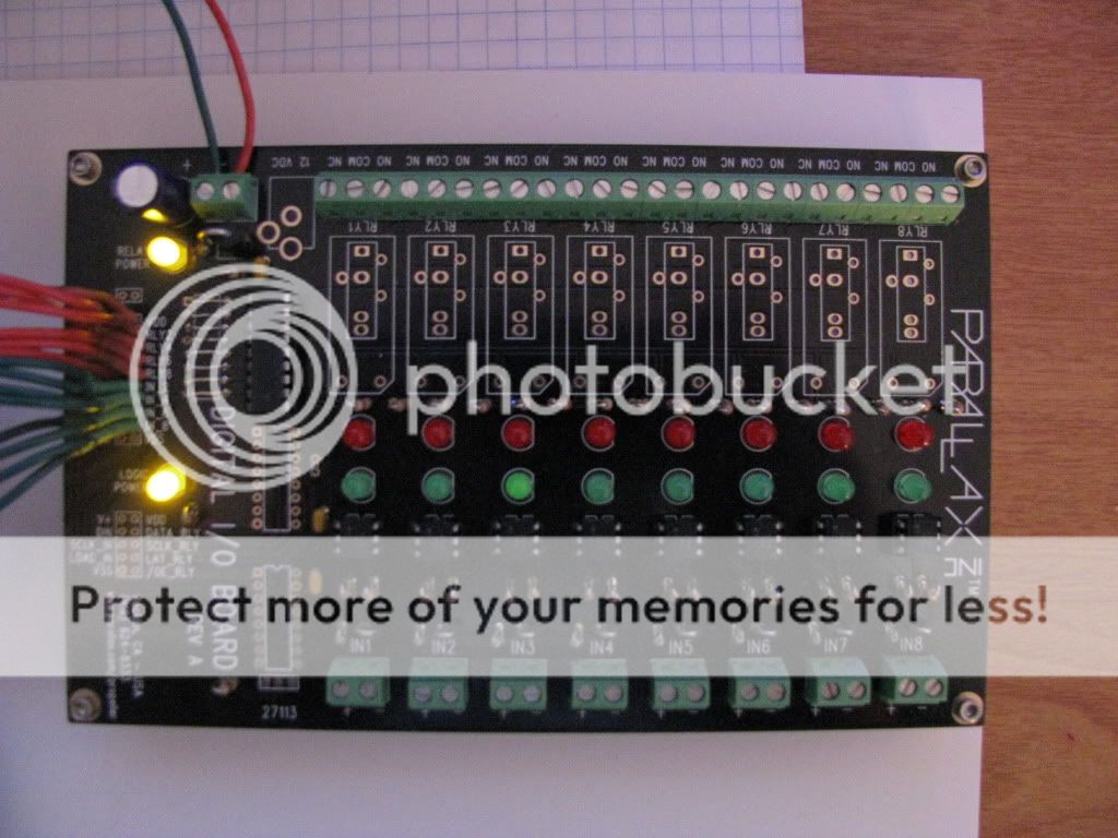

(Part I)
Parallax Digital I/O Board Kit
General
The main digital input/output "isolated" interface board is the Digital I/O Board KIT from Parallax. The Parallax Digital I/O Board Kit enables your microcontroller to interface to high voltage circuits allowing you to read up to 8 optically isolated inputs and control up to 8 isolated outputs. Inputs can be a voltage from 5-30VDC (AC compatible) and outputs can be either mechanical (AC/DC loads) or solid state relays (AC load only) that can switch up to 12A loads, such as cooling fans, solenoids, heating elements and more.
The Parallax Digital I/O Board Kit has the following features:
Mechanical and or Solid State Relay output
Configurable Input Voltage range
Serial or parallel interface to inputs/outputs
LED indication of power and input/output status
Hints & Tips
To use the Parallax I/O interface, 8 inputs and 8 outputs pins are needed - 16 I/O pins total. Since we are using the Gator/Gator+ with 28 I/O this was not an issue. We used this interface for easy I/O bit troubleshooting. For users with Arduino boards, the I/O requirement can be greatly reduced to 4 I/O pins by using the serial shifting in and out and using the built-in serial interface.
The cost of the board is fairly expensive but is well engineered ($50 USD) but it does not include the optional (extra) output mechanical or solid state relays. (User application requirement determined) For those, who are good at bread boarding, the cost can be greatly reduced by just buying the components needed and constructing a perf board. The schematic and instruction PDFs can be obtained at the Parallax.com website.
The Parallax I/O board needs two sources of power. The input 12 VDC "relay power" which supplies the control voltage for the mechanical and solid state relays. The "logic power" is a +5 VDC power for the opto isolator logic on the board. Both supplies will be needed and "sized" for the high current to the control to the circuits.
Since, the 8 amp solid state relay (AC loads only) and 12 amp mechanical relays (AC/DC loads only) have high amperage outputs, then only thru soldering can the relays be attached to the board.
There are no easy to use plug-in pin sockets due to the high amperage outputs. So, by chosing what type (Solid state or mechanical) and how many relays are critical due to the fact that
all outputs relays will have to be soldered on the board. Note: The relays can be mixed and/or matched.
The Parallax Digital I/O board has current limiting resistors (resistor pack) to limit excessive output current from the microcontroller. Since the Gator/Gator+ plus has 510 ohm resistors built-in, then we jumpered the resistors out on the digital I/O board. Using a standard Arduino, these resistors will save your board in case of excessive current draws or short circuits.
The I/O connections to the I/O board are done via ribbon headers. We used 22 guage wire in the header holes for a better reliable connection(s) to the microcontroller. There is also an option that uses the input +12 VDC "supply power" for the "relay power" VDD that goes to the microcontroller to supply the 12 VDC to the microcontroller board input regulator and then feeds back +5 VDC from the microcontroller supply to the I/O board for "logic power". Proper power supply "sizing" is required.
We installed 1.0K input resistors for 12 VDC photo isolated inputs instead of the 1.5K inputs resistors (default) for 15 VDC isolator inputs, which came with the kit.
Note: Different voltage photo isolated levels can be designed per user requirements.

0
Offline Offline
Sr. Member
Karma: 0

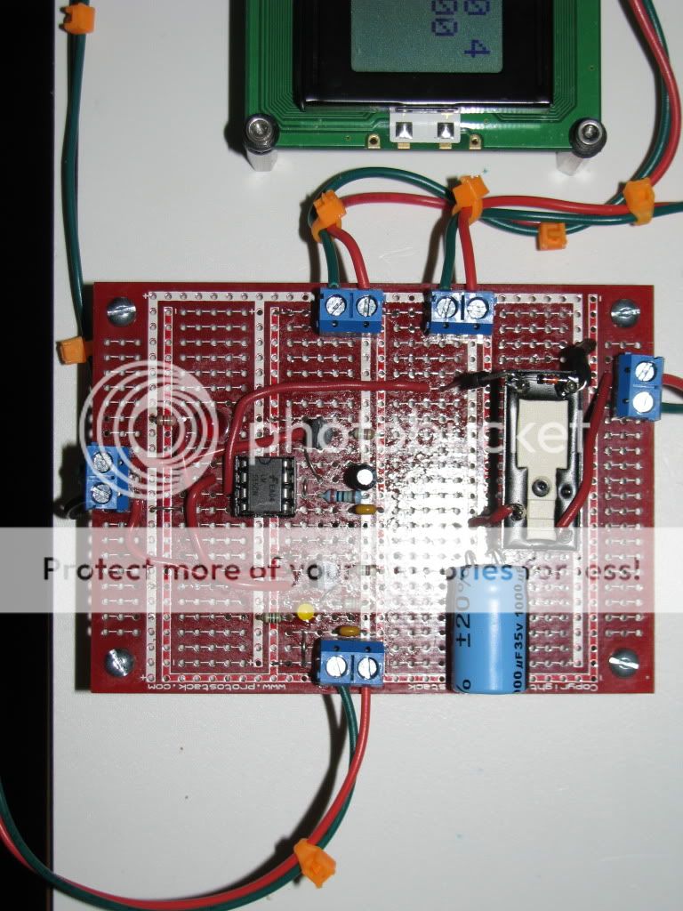

Part II - PLC Watchdog - design and schematic.
Below is the preliminary PLC WatchDog Schematic we used to build a "missing pulse detector" for our Home Automation PLC using
the Parallax Digital I/O Board. Arduino users can use this "preliminary" schematic as an engineering starting point to prevent equipment and property destruction
by disabling the digital control outputs when the following occurs:
#1. Microcontroller/Gator/Gator+/Arduino device failure.
#2. I2C lockups/hangs due to loss of device +5VDC vdc power or device failure, which hangs/halts the Arduino/CPU.
#3. Loss of device/system +5 VDC power.
#4. Microcontroller uploading which might cause the control digital outputs to turn on.
#5. Microcontroller software bugs or revision changes which could force the digital control outputs on.
#6. Software task timeouts or scan overruns. (Software stops the WatchDOG)
The microcontoller needs two digital outputs to control the PLC Watchdog.
One resets/restarts the WatchDog timer.
The other output pulses or "kicks the dog" to keep the WatchDog enabled via software control.
When the microcontroller fails, device fails or under software control the pulsing stops, all digital control outputs are disabled.
Note: You can use just one digital output but you need to manually reset the timer on all uploading, power blips or brownouts.
You could also prevent brownouts by using a computer UPS, which most modern PLCs already have built-in to their systems.
Note: There are no known problems with the PLC Watchdog ... yet ... further testing in progress.
Note: Watchdog part costs ~ $13 USD.
 8-) 8-) 8-)

0
Offline Offline
Sr. Member
Karma: 0
Posts: 308
Progress is made by lazy people-H Ford/R Heinlein
View Profile
Picture of PLC WatchDog breadboard module.
 8-)
