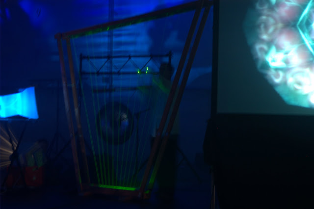

This is the first thread I've started in a while. Just wanted to share some pics of my Laser Harp controller (MkII) thus far and an earlier photo of my existing LH Frame in action.

MY HARP IN ACTION
