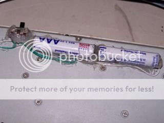

This is my project
Arduino Ps2 KeyBoard  TV Remote
[media]http://www.youtube.com/watch?v=HWORWJsqAjE&feature=player_embedded[/media]

int lastButtonState;
int buttonState = HIGH;
int recvButton = 1;
int recvState;
int irButton ;
int irState  ;
int test;
  code = kbd.read();
//keyBoard F1 setup IR
  if(code == 0x05){recvButton = 1-recvButton;
     irrecv.enableIRIn(); // Re-enable receiver
     if(recvButton==0)recvState = 1-recvState;}
///////// [ch3648][ch3611][ch3636][ch3604][ch3611][ch3636][ch3604][ch3585][ch3634][ch3619][ch3607][ch3635][ch3591][ch3634][ch3609] ir recv
  if(recvState == 1){
    digitalWrite(RECV_POWER,HIGH) ;
    digitalWrite(LED_1,LOW);
    digitalWrite(IR_GND,HIGH);
    GotoSetKeyBoard();}//[ch3605][ch3633][ch3657][ch3591][ch3588][ch3656][ch3634][ch3611][ch3640][ch3656][ch3617]
  if(recvState == 0){
         digitalWrite(RECV_POWER,LOW) ;
         digitalWrite(LED_1,HIGH);
         digitalWrite(IR_GND,LOW);
         GotoSendIr();} // [ch3626][ch3656][ch3591] code remote
//////////////[ch3648][ch3585][ch3655][ch3610] Code Remote [ch3605][ch3634][ch3617][ch3611][ch3640][ch3656][ch3617]////////////////////
void GotoSetKeyBoard()
for(int i = 0; i < 80;i++){
if(code == keyboard[i]   ){
       myValue[i] = codeValue;
       myLen[i] = codeLen;
  // [ch3629][ch3656][ch3634][ch3609][ch3588][ch3656][ch3634] Remote
  if (irrecv.decode(&results)) {
    digitalWrite(LED_1, LOW);
    storeCode(&results);
    delay(1);
    irrecv.resume(); // resume receiver
    digitalWrite(LED_1, HIGH);}
////////////////////// [ch3626][ch3656][ch3591] code remote ////////////////////////////
void GotoSendIr()
    /// [ch3585][ch3604][ch3611][ch3640][ch3656][ch3617][ch3626][ch3656][ch3591] Remote
    irButton = 1-irButton;
    if(irButton == 0)irState = 1;
    sendIrValue = myValue[i];
    sendIrLen   = myLen[i];
   /// [ch3626][ch3656][ch3591][ch3588][ch3656][ch3634] Remote
   if (irState == 1 ) {
    sendCode(LOW);
    delay(100); // Wait a bit between retransmissions
    irState = 0;}
////////////////// keyBoardCode//////////////////
void keyBoardCode()
  keyboard[0] = 0x075; // up
  keyboard[1] = 0x072; // down
  keyboard[2] = 0x06B; // left
  keyboard[3] = 0x074; // right
  keyboard[4] = 0x070; // lns
  keyboard[5] = 0x071; // Del
  keyboard[6] = 0x06C; // HOME
  keyboard[7] = 0x069; // End
  keyboard[8]  = 0x07D; // P up
  keyboard[9]  = 0x07A; // P down
  keyboard[10] = 0x16; // 1
  keyboard[11] = 0x1E; // 2
  keyboard[12] = 0x26; // 3
  keyboard[13] = 0x25; // 4
  keyboard[14] = 0x2E; // 5
  keyboard[15] = 0x36; // 6
  keyboard[16] = 0x3D; // 7
  keyboard[17] = 0x3E; // 8
  keyboard[18] = 0x46; // 9
  keyboard[19] = 0x45; // 0
  keyboard[20] = 0x4E; // -
  keyboard[21] = 0x55; // +
  keyboard[22] = 0x66; // back
  keyboard[23] = 0x0E; // ~
