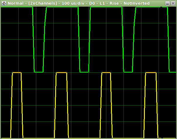

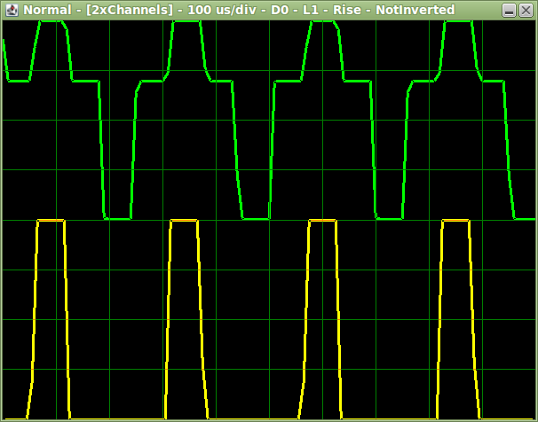

The current project is intended to help measure resistors with low value (under 1 Ohm) and capacitor ESR for those times when we want to test capacitors in a SMPS or other similar situations. Another interesting thing about this project is that it shows that over sampling is useful and can give very good results and can be employed successfully in other projects without the need to use external hardware; I had repeatable results in measuring low ESR capacitors and low value resistor (0.05 to 1 Ohm can be accurately measured). For information on using oversampling I highly recommend reading (http://atmel.com/dyn/resources/prod_documents/doc8003.pdf)

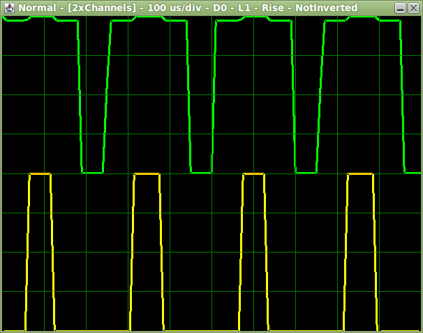

The idea behind this ESR is this: Using the well known formula U=I*R, we will pulse very shortly with a known current the cap or resistor, measuring the voltage on the element we have the necessary information to calculate the resistance. There would be a lot to write about this method and why this is functioning but probably more interesting is hand on experience.
The code: I tried to comment it at every step, it is written only for the 50mA current but very easily can be modified to add more upper range to the measurement (the hardware part is ready for this). Code could be rewritten for better performance using interrupts, etc, here is just a basic idea that works.
The hardware: Schematic is provided below, I designed a shield to arduino, probably not the best layout, be aware that the pcb was not tested yet and I’m not 100% is correct, did not use auto route and tried to make it single side, the schematic is good for sure and tested.
The schematic and pcb are attached (you have to sign in to download the atachment)
The DUT should be connected to CN1 between GND (pin3,pin4) and pulse and AIN0 (pin1,pin2) using a setup with four wires.

    delayMicroseconds(1);//on the scope it looks that after enabling the pulse a litle delay is
    //recomended so the oscillations fade away

I am curious will this get the ESR of a low cap value (pF, nF);
Thanks for your comments.
Logged
Romania
Offline Offline
Newbie
Karma: 2
Posts: 16
View Profile
Good question, the smallest capacitor I played with was 4,7uF value, this was not a problem to measure, the code presented here uses only the 50mA branch of the schematic (through R8 and the transistor), using the 5mA branch (through R4, the code must be adapted a bit) lower value capacitors can be measured (the smallest cap value that can be measured accurately I don't know). I don't have an reference instrument to compare with, but I guess if one needs to compare two capacitors and sort out the one with the smallest ESR this can be done easily with the current schematic, eventually the schematic can be modified for a lower current (increasing R4's value) so that when the current is applied to the DUT will not charge the small capacitor to quickly and distort the reading (increasing frequency should be necessary to), maybe another schematic with a true sine 100khz constant current generator or even at higher frequency as this is important for the small value capacitors can give better results. Sorry I don't have now this on my breadboard and can't test it. Probably the best way to know if this schematic is good for such small capacitance (pF, nF range) is necessary to study a bit the theory behind ESR measurement and make some calculation to know at least the theoretical limits of this device.
I just took a peak on the net and got to this page where is a calculator for reactance (http://www.electronics2000.co.uk/calc/reactance-calculator.php), as it turns out we must use a frequency where reactance will be negligible versus ESR, as this schematic uses aprox. something around 60khz (more or less) reactance becomes an issue beginning with the nF range, for pF we need something with several Mhz oscillations.
Sadly the answer is no measuring the ESR for (pF) range with this schematic, only the upper range of nF (even here reactance should be taken in account).

One question, how do you seperate ESR from ESL?
Some capacitors, especially those designed for low frequency use, can have very high inductive reactance.  I don't think your device can distinguish this.  You may think you have a cap that has very high ESR, but, in fact works very well at 120Hz, not so good at 10KHz.
Logged
Romania
Offline Offline
Newbie
Karma: 2
Posts: 16
View Profile
Good point, probably one way would be to test the capacitors at two different freq. high an low plus measuring the capacitance (computing the ideal values from capacitance and freq to get the ideal reactance and inductance) and than analyze the outcome comparing all the values and decide upon this result for a proper verdict of what the cap is good for and where it can be used, would be nice to have some capacitors with the same value and different ESR and ESL to test for this variable, the sketch could be modified to use different freq. This gives me an idea of a sketch where we could analyze the capacitor's response on a frequency range and plot the value and compare this to the ideal capacitor.

//this is where the magic happens, it really works and gives some
//incredibly good results! if you need sub milivolt accuracy is a good way to go
//noise is good ;) if in doubt must read oversampling on ADC from AVR docs
unsigned long measureESR()
  unsigned long samples = 0;
  unsigned int acumulator = 0;
  int i = 0;
  //oversampling 4096 times (for 16 bit is 4^(desiredResolution - ADCresolution))
  while(i < 4096) {
    digitalWrite(DISCHARGE_PIN,LOW);//disable discharging
    digitalWrite(PULSE_PIN,LOW);//making a miliVolt pulse of 50mA
    acumulator = analogRead(ESR_PIN);//reading value on AIN0
    digitalWrite(PULSE_PIN,HIGH);//stopping pulse
    digitalWrite(DISCHARGE_PIN,HIGH);//discharging the capacitors
    delayMicroseconds(600);//waiting a bit longer to fully discharge before another pulse
    samples += acumulator;//acumulating the readings
