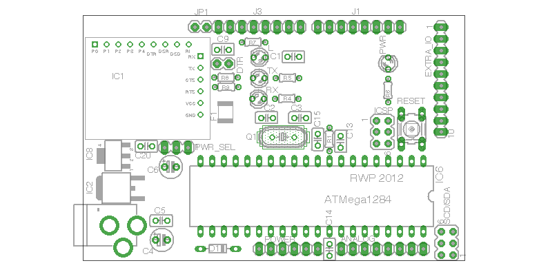

Okay, I had to re-do my .brd file, didn't seem to be anyway to recover.
Here's the new layout
and the files. Could use some feedback re: pin header labels - can't really squeeze things into the middle, the '644 placement is fixed by the ICSP header.
I suppose one way is make the board taller, slide everything up a tenth or so and out the labels around the outside.
Am using this neat little FTDI module vs the FTDI chip itself - figure the cost of the module and its parts is comparable to the chip, USB connector, some caps, and the hassle if soldering that chip in place!
http://www.mouser.com/ProductDetail/mikroElektronika/MIKROE-483/?qs=sGAEpiMZZMuNcqZxhMNT3znYT0k8AsjH
Got some ordered to try out.
If anyone's up for a review, here are the eagle 6 files.
http://www.crossroadsfencing.com/BobuinoRev17/atmega1284_DIP_thruhole.sch
http://www.crossroadsfencing.com/BobuinoRev17/atmega1284_DIP_thruhole.brd

I took a peek at the layout
very neat
I think there’s space to add pin labels outside the pins
I find that easier especially once a shield is in place

I made it a little wider, cleaned up the right angle traces, added header pin names.
Think the names are too big this way?
[edit- fixed couple typos in the link]
I took the liberty of "adjusting" your link!
but it looks fine to me certainly not too big
but then my eyes[ancient] appreciate larger fonts!
you might try labels that run the other way
so rather than one label per pin you have one loooooooooooong label
A7  A6  A5  A4 etc

I tried horizontal labels, they're ok for 2 characters, 3 run into each other too much.
