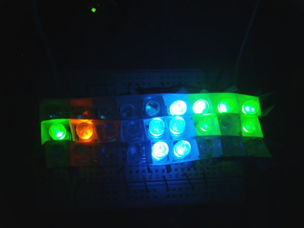

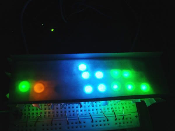

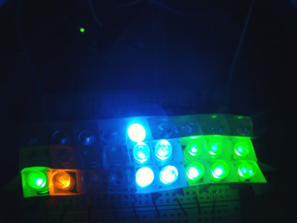

ever since I found this http://www.thinkgeek.com/interests/moms/7437/ i've always wanted one.
last year I made a python program that ran the graphics.py library and used it on my desktop.. now that I have an arduino I wanted to make a physical one..
so I wrote all the code by hand except for the time funtions. so it's very messy I haven't had the time to clean it up and i'm sure I've made a few.........a lot of progaming sins. so feel free to pick it apart and make fun of me..  ;D  it takes alot to hurt my feelings.
big thanks to raron for his help with the random function.
the clock stays surprisingly accurate I had it run for two days straight and it's not one second off.  the multiplexing was tricky I couldn't understand other peoples code so i tried to make my own based on what i understood on how it works. so some how it works it may not be the right way but it works.
Code:

forgot to mention that i'm planning on getting a wwvb receiver and sync it to the atomic clock.

Hi, great work! I ever loved the tix led, and now i want to try with your code!!! Can you tell me or send a pm about the led connection? Thanks!!

Nicely done!
I too have wanted one of these forever, and figured I could do one myself. Just need the time!
Do you have plans for a more permanent mounting (rather than breadboard)?
