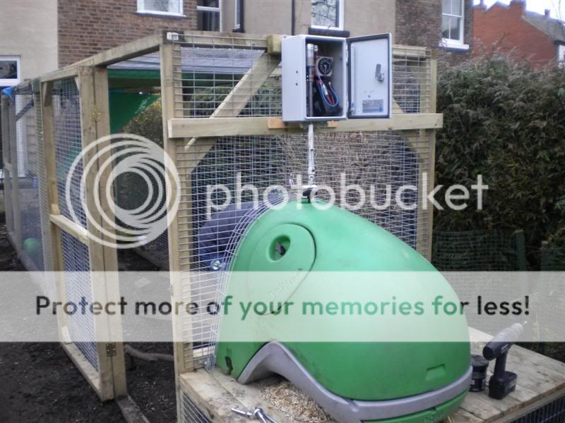

The door is attached to a long vertical bolt that needs to be turned 180 degrees to open\close (It's an Eglu Classic). I will make an arm to attach to the handle on top of the coop to do this.

Hey, any reason you are wanting to use a geared motor and not a servo?
madlan
I was hoping for a slow gradual movement, to stop any heads from being removed! Will a servo have this  ability when controlled from the board?
I have a 12V solar panel and battery so hoping to use a 12V motor.
Here's an example of a fellow owners setup.
I don't have anything above the coop, the only mounting points are the coop itself or a fence post nearby.
I was thinking of a long threaded bolt connected to a 12V motor and some kind of mechanism that rotates as the thread turns (connected to the handle)
