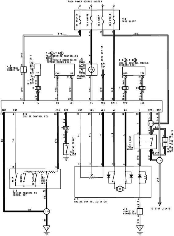

Ok, I pulled off my factory cruise control actuator, and in true Land Cruiser fashion, it's WAY overbuilt.
Here are pics:
t0mills
All of the drive gears are metal, the electric motor (huge) uses very nice bronze bushings for the worm gear, and that worm gear is actually driving a massive round gear that is located underneath the plastic cover (where you're seeing all of the wires).
The plastic gears that you are seeing are only part of the encoder system (I'm guessing that's an encoder system, anyone know for sure?).
Here is the wiring diagram for that system:
