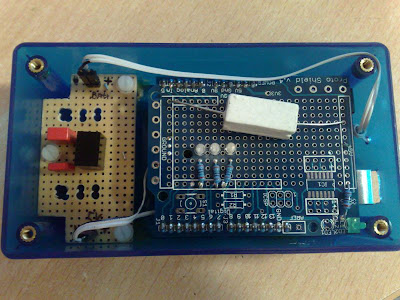

Hello,
like the mpgduino, i want to make a display for the car what displays health data from the engine.
Planned are: Lambda, Exhausttemperatures, Intakepressure, and some more...
Currently it can show Lambda, but only on my Desk  smiley-grin
The Code is here: http://code.google.com/p/multidisplay/
and everything about the Powersupply: http://code.google.com/p/multidisplay/wiki/Powersupply
The Prototype:
And a Example Display:
Planned is to have it installed next winter into my car, hope that works  8-)

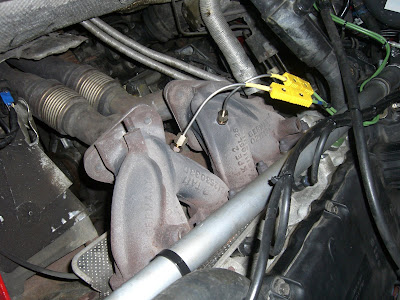

About Lambda:
when having a tuned engine the Lambda value is a great "health" indicator.
it shows how rich or lean the engine runs, during normal cruise it should be quite normal, but when hitting it hard it must always be slightly rich.
If you run lean (fuel system defect) during full load the exhaust temperatur will skyrocket and your piston/valves can melt away...
Thats way im also having exhaust temp probes installed:
and later the arduino will look up this this 2 Type K thermocouples.
have already some ideas about arduino with type k thermocouples: http://www.designer2k2.at/index.php?option=com_content&view=article&id=19:thermoelement-typ-k-an-arduino&catid=13:arduino&Itemid=40
its german but the google translation to english is quite good!
http://translate.google.at/translate?u=http%3A%2F%2Fwww.designer2k2.at%2Findex.php%3Foption%3Dcom_content%26view%3Darticle%26id%3D19%3Athermoelement-typ-k-an-arduino%26catid%3D13%3Aarduino%26Itemid%3D40&sl=de&tl=en&hl=de&ie=UTF-8

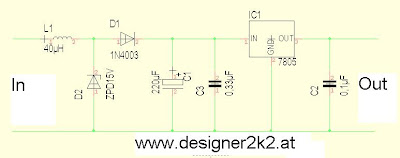

after 1 week testing, the powersupply failed...  :-[
it heats up to 75°C at 20°C ambient, in a car thats no good   :-X
The "demo":
its a 33Ohm 5Wats resistor, simulating a little bit more load than only the 3 led´s
With a thermocouple measuring the temp of the heatsink.
and that with a quite big heatsink:
Problem is the 7805, it must kill to much power. So a DC/DC converter will take its place:
http://www.recom-international.de/pdf/Innoline-2008/R-78xx-0.5.pdf
This thing gives 5V at a 0,5A without Heatsink, with an huge input range (6.5V - 34V)
And a nice addon, its pin compatible with the 7805  smiley
So now parts are ordered, and the testing continues  8-)

the DC/DC converter is mounted, and the temperature dropped to 28°C, so only 8°C above ambient  smiley-grin
and ive got my 20x2 LCD (Displaytech 202A-CC-BC-3LP), what should be easier to mount in the car:
Next step is to get it hopefully next week into the car for a testrun, and then start with the RPM Input.

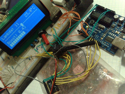

its getting close to put it in my car  smiley
current code: http://code.google.com/p/multidisplay/source/browse/#svn/trunk/work_designer2k2_02/work_designer2k2_02
looks a bit like this:
im using a MCP3208 as ADW, so i have enough pins for some buttons...
besides the LCD its streaming all 8 ADW pins as csv over the serial interface, including a "milis" timestamp.
So it can be used for logging in combination with a notebook  smiley
i still need to get the RPM measurement running, not so easy as i thought...  :-?
