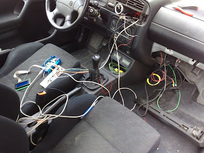

it runs  :D
[media]http://www.youtube.com/watch?v=SKleYUhgoo0[/media]
and so md_001p0 is released (http://code.google.com/p/multidisplay/)
the car installation is a mess right now, but who cares, it works  ::)

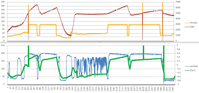

a very nice addon is the datalogging:
a short run:
detailed:
very detailed:
it updates every 15ms, fastest i can get is every 7ms, but there is no need for that...

thanks to my VW, its quite easy, most signals are already 0-5V  ;D
