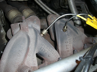

im measuring EGT directly after the cylinder head (cyl 1-3 and 4-6 have their own sensor), and my water injection keeps it from jumping to high when hitting it  smiley-wink
