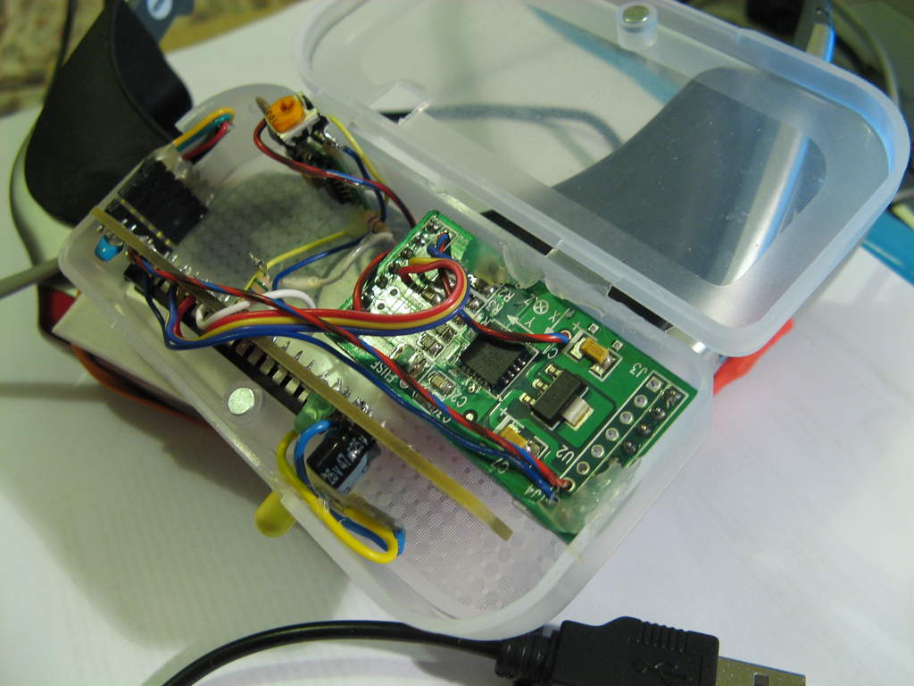

I posted it at RC Groups, but a couple of people have asked me for the code, which I thought would be more appropriate to post here.
(For more detail, check this thread:
http://www.rcgroups.com/forums/showthread.php?t=964184)
But I thought people here might be interested in it, especially the code.
It's a 3 degree of freedom (pitch, roll, yaw) head tracker built from:
  • A cheap RC heli gyro for ~$15
  • A cheap 3 axis accelerometer board for ~$16
  • RBBB for ~$12
The final goal is to fly my FPV plane through VR goggles, but I'm currently testing it with Microsoft FSX, here's a video:

Here's the code, will need to be modified to suit you own setup. Also, if anyone wants it, I've got a program that interfaces with FSX camera control and serial port, all you need to do is send a comma separated string of pitch, roll yaw and so on. Should make it easy for anyone wanting to control FSX camera from arduino.

yikes, I have all these pieces, and would like to put them together! Could I ask you to post a schematic, or more detailed pictures of the build, so I can see your wiring... at a glance, it isn't all obvious to me.
thanks,
david

waxweb,
It's not very difficult to put them together, but which parts do you have? The only difficulty is figuring out what where the gyro outputs the analogue signal, but that is different for different gyros.

hi Zitron,
I have a sure electronics accelerometer, and a rbbb, but missed the gyro on the list... which is the one you used, from the page linked to at r2hobbies? Right off, looking at your photo, I was confused by: the trim pot [is that the gyro?]; the connection between + and J2/sleep; and what appears to be an extra resistor off the bottom of the rbbb. I ask 'cause, as a noob, small errors repeat endlessly when guessing a build.  thanks, and cool work!  david
