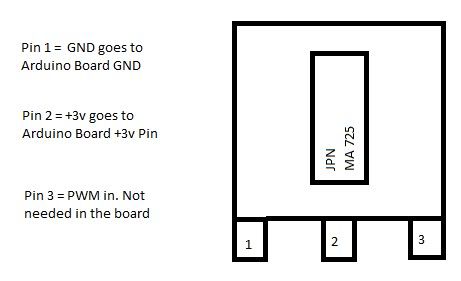

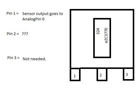

psicrest
Can you help me out how you wire the gyro on the arduino. I have the same gyro. i just want to experiment with it but i couldnt make it to initialize. Been googling for hours to find an answer. Im a newbie in arduino and electronics, but i do have some soldering skills and some basic electronics knowledge.
zitron
See: http://www.rcgroups.com/forums/showpost.php?p=11857416&postcount=33
psicrest
Which ones goes to arduino?
sensor output = analog pin 0
3V in = 3v arduino pin
GND = GND
I tried it and did an analogRead(gyroPin) which gyroPin = 0
im only getting 667 +- readings.
psicrest
I noticed that your code has Vin on it. Do i need to put something in the Vin pin?
Ref Voltage = Vin ?
psicrest
Im also wondering about the potentiometer, im not sure how you wire it.
And i think you put a resistor also on the Sensor out. Could you please help me with the wiring? Thank you in advance.
