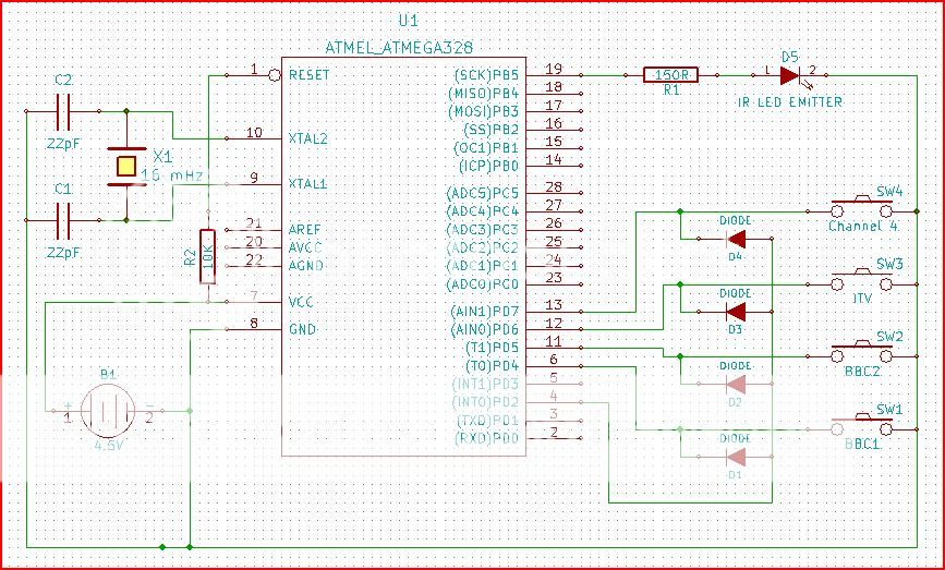

Here is the circuit diagram -
D1 to 4 are any small-signal diodes. R1 limits the IR LED current to 33 mA. R2 holds RESET high. I don't know if this is strictly necessary, but I didn't want to take the chance.

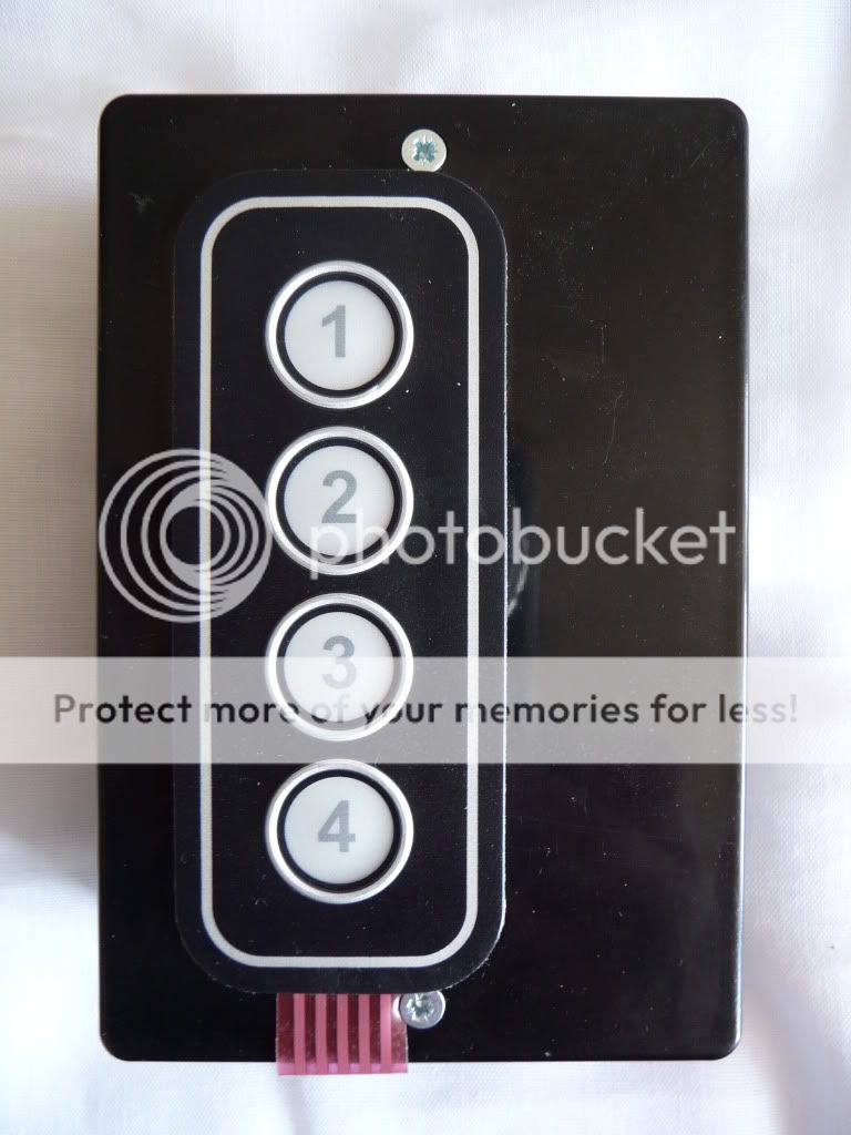

And here is the finished article -

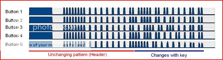

The first job was to learn the codes sent by the remote. There are plenty of sources for how to do this, so I wont go into that. Here are the patterns that I acquired. The waveform represents the bursts and spaces sent by the remote. I noted that the first section was unchanging, so I called this the header. Presumably this is to sync the receiver.

Why don't you reply to your first post, so everything is contained in one single thread?  Otherwise you will have comments in both threads, and it just makes things a big mess!
Nice work though, although I am unsure as to the purpose of the diodes on the buttons, in my (limited) experience, that would only really be required if you had them in a matrix of some sort.

Quote
Point well made. I'm a bit new to this.
The diodes are there to pull the Interrupt pin low when any key is pressed. They perform a logical OR function.
I agree about the coding deficiencies, but neither speed or size are an issue in this case.
Thanks for the feedback.
nickvd
Ah gotcha... now I see it :)  thanks for the clarification (and education :))
