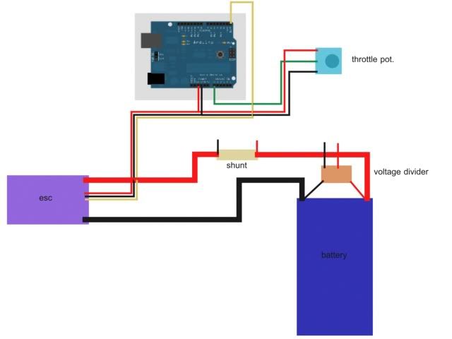

I am building an electric bike using only RC parts (bdlc motor, rc esc..)

Now i wont to try measuring the current using a shunt resistor, but i am not sure how to connect all that...
I am new to electronics, adruino and programming, so all this is a great learning experience for me..
this is what i am not sure how to connect.. the voltage divider and the shunt resistor
the arduino is powered by the esc(which have constant 5v power supply) connected to the arduino 5v - this is tested and working fine
if i connect only the divider.. the - to arduino gnd, and + to analog pin i think that it woult work just fine (if the voltage stays under 5v)
if i connect the shunt the same way.. - to gnd, + to analog pin, i think that there is no problem too, it should work (off course under 5v)
but i am not sure in to conecting both at the same time.. maybe i am wrong..
i am not sure what will hapen with the arduino power supply if all that was connected, it would have - from the esc, voltage divider and shunt connected to arduino gnd, + from esc to 5v, and two other + but through analog pins, coming from the same battery...

The first thing you need to find out is whether the ground connection from the ESC to the Arduino is connected inside the ESC to the connection from the battery negative terminal. Depending on the answer, it may be easier to put the shunt in the negative battery lead. What voltage is the battery?

vwteo
What is the best way to find out whether the esc ground connection is connected to the battery negative? :smiley-red:
The battery is 8s li-po, so the voltage is between 25,6v(empty) and 33,6v(full)
You could disconnect the battery and use a multimeter to measure the resistance between those two points. If it reads less than 0.1 ohms or so then you can assume they are commoned. Alternatively, with the unit powered up and the motor operating, measure the voltage between those two points. It will be zero if they are commoned. Also, look at the data sheet for the ESC, it may say that they are commoned.
