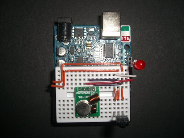

Here is a picture of the finished device. The LED on the top right is simply inserted between pin 13 and ground and blinks shortly when a valid IR-signal is received.
The wirings may seem a bit strange, most of them were just inserted to reposition the parts on the breadboard.

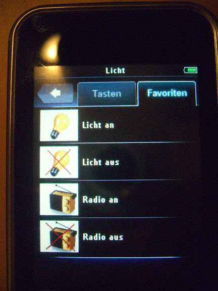

That's it so far. Let me just show you how I configured my remote control to comfortably switch my RF devices. The remote control has a configurable touchscreen. You can even add own icons. Here's the result:
Hope that this idea and this posting is helpful or at least interesting for someone else! I look forward to your comments!

The remote control device seems very cool. It has touch screen!
Where can I more information about it?
Logged

The remote control is a Philips Prestigo ST9320.
The touch screen is not the exactest one but still very nice and the concept is very cool. It has a huge device database, you can reposition the buttons of your remote controls on the touch screen as you want, you can add Favorites and store them with the channel's symbols and, it has a good usability, because it is not overloaded with buttons and, quite important for me, it is by far the remote control with the best design (in my opinion )...
It replaces all my remote controls completely, I've never had to use the original remotes since all functions for my devices are there...
I can even open open my car with it (I have quite an old one with an infrared central locking system) smiley-grin
