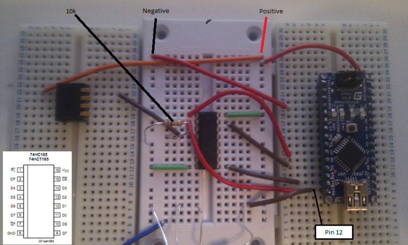

I'm getting some strange data from the SN74HC165N with both this code and this code, I have one switch for the SN74HC165N to read for the moment and is wired:
This is the pin designation:
int ploadPin        = 8;  // Connects to Parallel load pin the 165
int clockEnablePin  = 9;  // Connects to Clock Enable pin the 165
int dataPin         = 11; // Connects to the Q7 pin the 165
int clockPin        = 12; // Connects to the Clock pin the 165
I'd expect to see the data on D5 to change on flicking the switch but each time it reads the shift register it reads different values as if there are 8 switches and being randomly flicked, does anyone know what the issue could be? I've found people have used 10k or 4.7k resistors, would it be worthing trying a 4.7k? I don't have any so I'll get some if it's worth trying.

Yes, you've got it, you have floating inputs, not good.
Pull-up or pull-down to a known (default) state.

You already have a 10k pulldown resistor on D5. Changing it to 4k7 isn't going to make any difference. The other 7 inputs are floating, so expect to see random values for them. If you ground D0-D4 and D6-7, what readings do you get?

You should also include a small decoupling capacitor on VCC of the 165.  0.1uF Ceramic.

Thanks guys, in my ignorance I thought I'd simplify the test by only using one switch which gave me floaters!

The rule with CMOS logic is no floating inputs (this causes various problems and can lead to continuous conduction through the gates' output stages).  If you are designing a battery powered circuit using CMOS logic (for low power) then it really matters.  The supply current to this shift register might be a few nanoamps in normal use, but with a floating input might rise by a factor of _millions_ to many milliamps (flattening your battery in hours).  In the case of an Arduino you would have to be using sleep mode and battery power for it to matter, but I'd still eliminate the problem, its poor design to allow floating inputs.
For CMOS connect floating inputs directly to GND or +5V as appropriate it not sending signals through them, otherwise pull-up or pull-downs may be useful (say the input is driven from an external device that isn't always connected, then a pullup or pulldown will stop it floating when not connected).

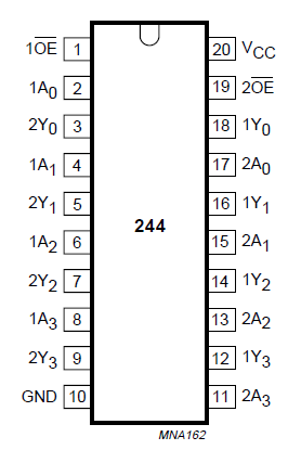

My last post failed, it had the datasheet. apparently the upload folder is full.
Is this what you were posting? http://www.learn-c.com/74ls244.pdf
This is the pin layout
for the shiftIn would I wire it:
8 trigger switches --> 8 input pins on the 74AHC244 --> 8 output pins on the 74AHC244 --> 8 input pins on the HC165 --> data pin to Arduino
shiftOut:
data pin on Arduino --> 1 74AHC244 input pin --> 1 74AHC244 output pin --> HC595 data in PIN --> 8 HC595 output pins --> 8 LEDs
Thanks in advance
