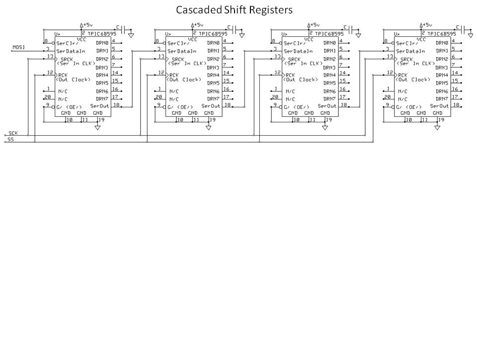

so I'd just send the segmentary binary over SPI? <goes to grab the SPI docs>
Say I had 2 displays, about 5 feet apart (opposite side of car).....I'd have 8 shifters total running on 3 wires plus power/ground? They'd all share the SCK and MOSI, each would just have a different SS pin on the mini? So I could use another Cat5 cord to connect the 'slave' display to the 'master' display? SSx4, SCK, MOSI, +12V, and GND?
KF5RVR
magnethead794
read the SPI docs. So each shifter would have it's own SS pin- but I could tie the mirrored shifters together to save pins on the mini. So I'd need four SS pins along with the 2 default SCK and MOSI pins- 6 total.
Just have to read up on controlling shift registers.
KF5RVR
CrossRoads
Yeah, I think I follow that. Be 2 boxes, each with 4 shift registers, one talking to other?
Each display set would have 4 shift registers in series, only need 1 SS for each set. Or just 1 even if both are displaying same thing.
Re-reading, sounds like you have off-board regulator, I moved things around to have headers/holes for regulators and for the segments.
Was also thinking you'd have off board resistors for the digits as they are 12V displays.

I'll research driving shift registers. I REALLY like how this is coming out! Not sure how cascaded shift registers only need one SS, but i'll see fif I can't learn!
Be nice if the drains were all on one side, but I'll take what I can get!
A thought: I could EASILY fit the control system inside a 3"x2"x1" enclosure by affixing the shift registers directly to the display boards! So If I made a PCB (from iTead) that connected the a,b,c...f,g connections over to the shift register, then I would only need SCK, SS, MOSI

Found this: http://bildr.org/2011/02/74hc595/
So it's not true SPI. It's just data manipulation by pulling digital pins high and low.
So something like this?
pull Register Clock (RCK, pin 12) LOW (freezes display)
enter for loop (number of digits){
-enter for loop (number of pins, 7 for a 7-segment){
--pull serial clock (SRCK, pin 13) LOW
--send bit to Serial In (pin 3) (which goes to serial out, pin 18, and on to the other shift registers)
--pull serial clock (SRCK, pin 13) HIGH
push Register Clock (RCK, pin 12) HIGH (refreshes display)

Yeah, that's another way to do it. I don't why you would when you can just write a byte to a register and have the internal, built in hardware, that is designed to do just that, take care of it for you.   You mention 200mph dragster and then go back to a slow software method for outputting your data.

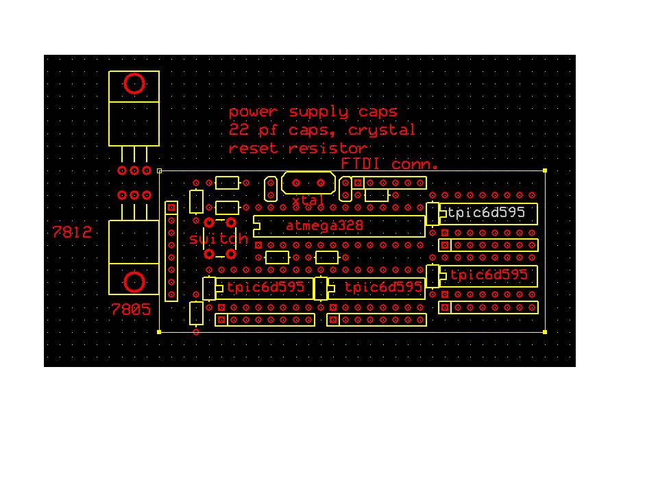

been up all night and just started forcing myself to learn eagle.
Here's where I'm at.
http://i1105.photobucket.com/albums/h355/magnethead494/dial_board-1.jpg

Moving forward by leaps & bounds - surface mount can't be far behind now ...

The plan is to fit the 328, oscillator, 5V regulator, and shift register all on one 2"x2" board with pins 5, 6, 7, A0, A1, and A7 broken out for future use. That will be the main board.
The other 2 digits will have slave boards, which will only have the shift registers on them. In the case of a double-sided display, all 3 boards on the secondary will be slaves. That makes everything fairly plug-and-play.
The digit selector will be 3 knobs with another 328, oscillator, ect hiding out back. Ditto with the indicator. It's going to be one mad science experiment. 3-way serial between master/selector/indicator and dual daisy chained SPI shift registers. Sounds complex, amazing how simple it really is. Nice part is how easy the packaging will be.

Here's where I'm at on the schematics.
http://i1105.photobucket.com/albums/h355/magnethead494/dial_board_master.jpg
http://i1105.photobucket.com/albums/h355/magnethead494/dial_board_slave.jpg
http://i1105.photobucket.com/albums/h355/magnethead494/dial_board_selector.jpg
http://i1105.photobucket.com/albums/h355/magnethead494/dial_board_indicator.jpg
I'm not sure what part number for the oscillator..mouser only has one xtal and they want $15 for it.

I find your schematics very hard to read.
Can you create them doing this instead of whatever you did:
File:Export:Image, select Window (vs full), adjust the Resolution (DPI) so picture is ~800 x XX. Then post that.

Thanks. Not sure why Mouser wouldn't have something that simple (unless I overlooked something). I buy from there since I get everything through will-call, no shipping charge.
Sorry, I used print to PDF then converted to image (should be approx 1500 pixels wide, using A4-A1 paper size at 3x scaling). This method seems to have shrunk them down alot? I'm using .025 grid spacing spanned across 3 monitors, wasn't sure if that was going to affect the size.
http://i1105.photobucket.com/albums/h355/magnethead494/master_2.png
http://i1105.photobucket.com/albums/h355/magnethead494/slave2.png
http://i1105.photobucket.com/albums/h355/magnethead494/selector_2.png
http://i1105.photobucket.com/albums/h355/magnethead494/indicator_2.png

The pictures are not legible. Maybe photobucket is hosing them. Use the Select button (looks like magnifying glass over a piece of paper) to get the image as big on the screen as you can before exporting it.
