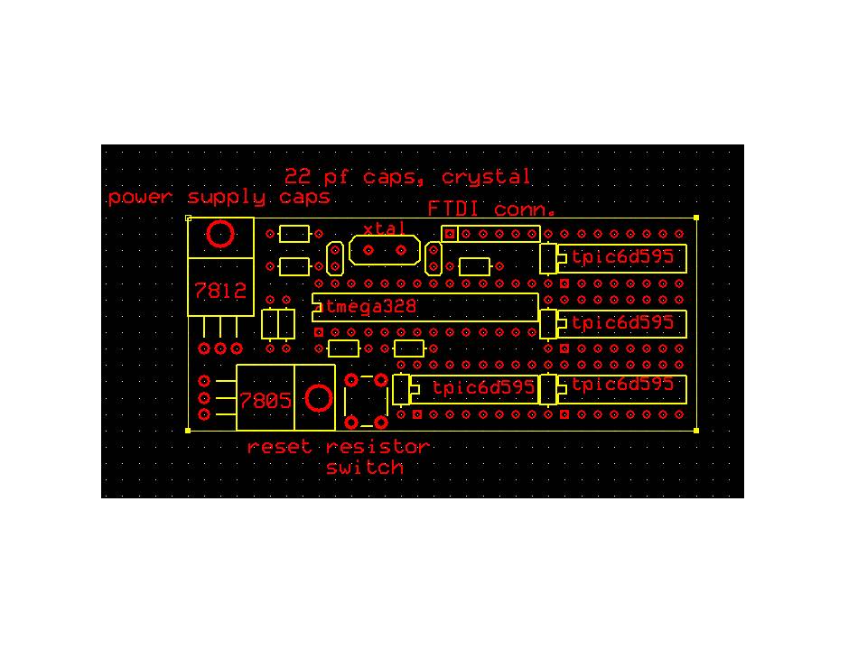

to cut cost, I'd like to control a 12 volt 4 digit 7 segment array using a Mini. But I don't understand what I need for a high side driver. I've read that I need to drive a PNP using an NPN, are there any better ways? This has to fit in a 2" x 2" x 1" enclosure. I keep seeing shift register come up as a high side switch, but I don't see how that is possible?
What about using FETs?

How about driving 4 TPIC6B595 shift registers via SPI interface, one for each digit?
Yeah, its not multiplexing, but its easy write the digits, they handle 12 volts, don't need high side drivers.
They handle 150mA per segment. 84 cents at Avnet.
https://avnetexpress.avnet.com/store/em/EMController/Counter-Shift-Register/Texas-Instruments/TPIC6B595N/_/R-1750249/A-1750249/An-0?action=part&catalogId=500201&langId=-1&storeId=500201&listIndex=-1
Or use a 6D595, 100mA/segment for 57 cents.
https://avnetexpress.avnet.com/store/em/EMController/Counter-Shift-Register/STMicroelectronics/STPIC6D595B1R/_/R-5750380/A-5750380/An-0?action=part&catalogId=500201&langId=-1&storeId=500201&listIndex=-1
Only need 3 pins - SS, SCK, MOSI, sometimes all the multiplexing is just not worth hassle!
Both available in multiple surface mount versions as well.
Nowhere enough room for 4 DIP10's. The board only has 30 columns and I'm restricted on size. Also have to fit 2 voltage regulators on the board.
If they're 8 bits, can't I still multiplex, one digit per drain?
I'm removing one switch, and moving it to the center of the board. It's a on-off-on SPDT switch with a resistor between the 2 end poles (used for dimming). The top horizontal will be voltage to the sourcing circuit for the LED's, the bottom horizontal will be 12V, and the column above the switch will be 12V with a resistor (68 ohm) on it.

Yes, can mulitplex the shift register across the digits. Still need to switch the 12V on/off to the common cathode of the digits tho.
I' d personally ditch that board you have, get an "island of holes" board, futurlec.com has plenty of options, cut down to size you need, and have the WHOLE board available for use.  You're backed into a corner with that thing.
http://www.futurlec.com/ProtoBoards.shtml  $1.50
Those do me no good. I need something small to fit in a 5x2.5x2 enclosure. Eventually I will transfer it to PCB and fit it in a 4x2x1 enclosure (the thinner the better).
So if I multiplex source on the register and sink on the darlington, that's a DIP20, DIP18, a STDP switch, and 5 pins for the voltage regulators. Leaves 3 columns empty I think. Sounds good.
Everything stays self contained on that board, regulators go off-board, and an RJ45 breakout (or two) and the mini.
Wait- aren't these low side drivers? I need high side. For something so simple, I don't understand why they don't exist (particularly in DIP form). Seems to me there's no difference between the chip you posted and a darlington, other than being SPI rather than direct drive.
Can I simply use 4 Logic Level P-FET's, one per digit, rather than driving a PNP with an NPN?

Buy the board, cut it down to the size needed, wire up your circuit. You are really limiting yourself on usable board space by insisting on using the strips.

Woohoo, that is rich! I propose a piece of $1.50 perfboard and four 56 cent shift registers, you come back with a $12 part.
Well, I guess it is true, can lead a horse to water ...

So replace each darlington with an 8 bit shifter. How do I command which output is on?
So I'd only need 4 pins of the Mini to control 28 segments?
Ideally if I used a land of holes board, I'd have to cut tons of traces?
Idea would be to fit everything in a 4x2x1" enclosure. The shift registers would take up 2 linear inches, leaving 2 more inches for the mini board, RJ-45 breakout, and heatsink/regulators. Then mount it all to the enclosure using the switch. It should weigh low enough that vibration shouldn't make it break loose. (This is an exposed part going on a ~200 mph dragster)
Once I get it on PCB, I figure I could fit everything on a single 2" square PCB, including the RJ-45 connection.

No, only 3 - SS, SCK, MOSI, and could be 32 (7 + decimal point, use as warning lights or something, : , etc)
Code:
digitalWrite(SS, LOW);
SPI.transfer (digit1); // data can come from an array even:  SPI.transfer ( displayArray[digit1data] );
SPI.transfer (digit2);
SPI.transfer (digit3);
SPI.transfer (digit4);
digitalWrite(SS, HIGH);
[code]
and in the rest of void loop you create/determine/whatever the digit data will be.
displayArray[0-9] will be the high/lows that create your display of a 0, 1, 2, ...9 or maybe letters A,b,c,C,d,E,F,g,h,i,J,L,P,U
