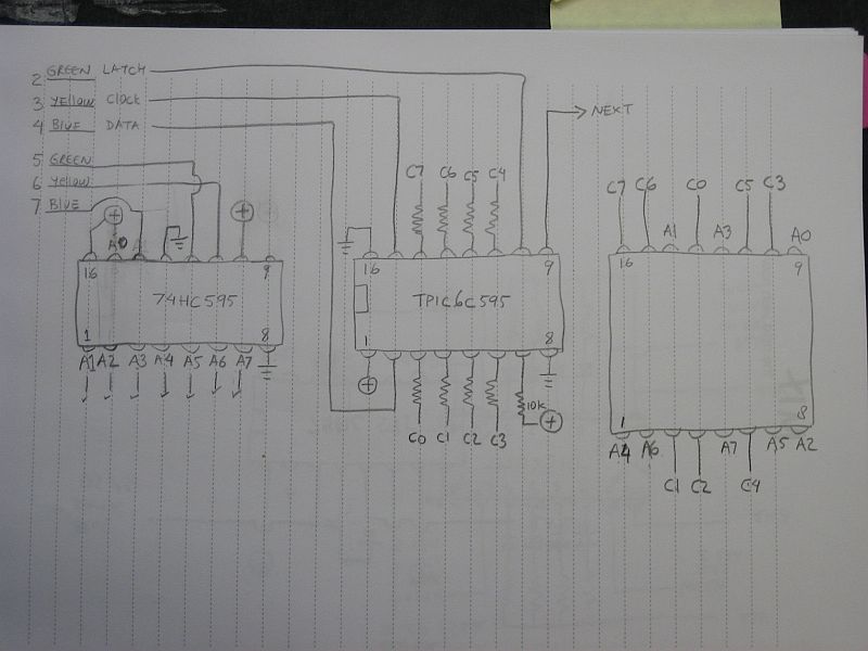

I put resistors in rows, not in cols.
Is that make problem?
Sharing one resistor among up to 56 leds is probably a bad idea because it would alter the brightness of the leds widely depending on how many of those 56 leds are on when that row is on.

how would I change your code to use matrices who's columns are the anodes, rather than the rows?
Sorry for responding so late.
I may be mistaken, but I believe unlike 74HC595, TPIC6C595 can only drain into ground and cannot supply positive to the anode columns of your matrix.
There's probably a chip similar to TPIC6C595 that would work with your matrix, but I do not know what that is. :-(
I use 74HC595 for both row and cols and use CA matrixes.
I invert the bit of the characters. It's works!

The TPIC is the same as the 595 but it has higher current output. The code will be identical. There is another chip HEF4794 which is also a high power output chip but only drives 40ma.
The standard 595 chip will drive 1 LED per output fine but if it needs to drive more you're going to have to boost it's output.

Hi everybody at the Arduino forum!
Hari, is your homepage down for good, or are you improving it?
I would interested in the "56x8ScrollingLEDSchematic.jpg" picture as I am doing this same project myself for school project. Need some help with the wiring as I am designing a circuit board for this.
Is there anyway you could send it to my email, if you still have it on your computer?

Oh sorry about that...
I've added the schema to the end of the blog post.
http://g33k.blogspot.com/2010/02/arduino-56x8-scrolling-led-matrix.html
Good luck with your project!  It is a lot of work, but very rewarding.
