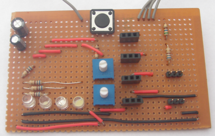

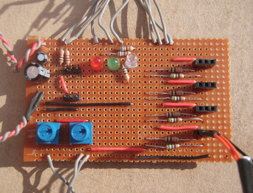

DuaneB
   So that I don't feel like a fraud, thats the original circuit which I could never get to reliably, the current circuit is -
I have just updated my original blog post with both circuits here -
http://rcarduino.blogspot.com/2012/01/traction-control-part-13-we-have.html
I suggest you get some decoupling capacitors for cleaning shared power and also some heat shrink tubing for insulating self made cables and connectors on your shopping trip.
For generating the signal, use the servo library on any of the digital pins.
