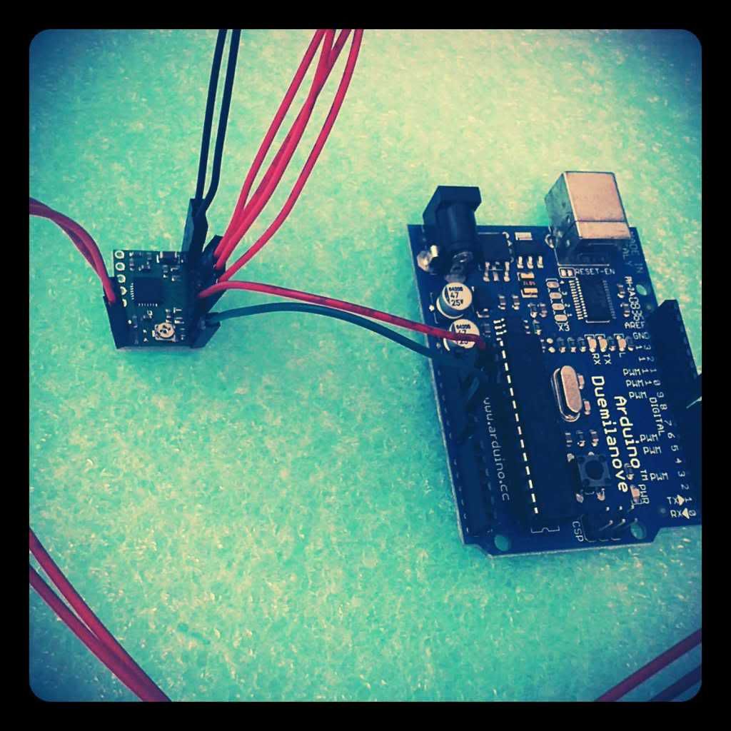

bobby2sox
Do you think it would be fine to power this up like this?  Not soldered... just with some jumper wires stick into the holes and down into some foam?
marzetti
Looks a bit flaky to me. I would solder the male headers provided with the board to the bottom side and insert these into a pair of female headers soldered to some perfboard. (I tried to insert a picture but it didn't work)
marzetti
#11
Apr 27, 2012, 07:17 pm Last Edit: Apr 27, 2012, 07:22 pm by Yankee Reason: 1
Inserting an image didn't work so here it as an attachment:
You can also see a heatsink I fashioned out of a piece of copper sheet that clips to the driver. It helps a bit but could be better.
Be aware that the bottom of the board is utilized to heatsink the chip so setting it on the foam will not allow airflow for cooling.
