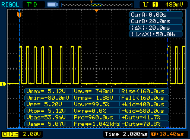

built a new "shield" and i've got chris' code running on a duemilanove with working pin 10 now!
any clues to where i should look for variables to invert the ppm stream? i tried inverting / reversing pulse = map but that didn't get it. i tried multiplying some stuff by -1 with no luck. not sure what else to look for... :-/
-sj

Hello again,
I am not sure exactly which version of the code you are using, but look for this line (it should be on the 'timer' tab)
TCCR1A = B00110001;
 and change it to
TCCR1A = B00100001;
That should invert the output for you.
The reason this works it that the output it created using hardware timer1 and we need to change the way that the output compare register effects the output of the signal generator. (see page 136 of the ATMega368 datasheet for more info...)
Chris

sweet! that did it, thanx!
i KNEW i had seen inverting somewhere... just couldn't put my finger on it; that manual is LOT to take in!
the spektrum module is recognizing the PPM train as it lights up and binds to a rx. servos are whilin' out though so i suppose i need to make some tweaks to the pulse or frame lengths. there are some slight ripples in voltage (not sure what that matters) but the pulse timings look solid!
*edit* - im using your Version_0_2 code

The voltage ripples are tiny and shouldn't make any difference at all.
What is it your sevos are doing? My thinking is this: if you are missing some channels then try increasing the frame length. If the servos are unstable then you could try increasing the padding time (this is the time the signal spends high) it might help to look at the output from your receiver.
Nice scope by the way. I wish mine did that, but it is 25 years old and I count myself lucky if it takes less than five minutes to warm up!

View Profile
Quote
thats what i thought too... but andykunz of spektrum mentions ac or dc coupling here. not sure how that applies yet though...
Quote
i think it would be best described it as jitter or constant twitching regardless of position. i tried extending the frame length to 25ms as mentioned in this thread but it didn't seem to help. i'll try adding to the padding next.
when i first loaded ian's code i had some jitter from the servos that seemed to clear up after calibrating the sticks. monitoring the rx outputs made setting up the sticks a lot easier! i'll try that in a minute too!
Quote
thanx, lol! i purchased this one after much fighting with my dad's Telequipment scope of the same era! i've had it less than a week and im hooked! its surprisingly well built, is easily converted to 100mhz, small, light, cheap, and has a Auto Button!  smiley-wink  heres a link if you're interested. link
cheers!
-sj
Logged

its definitely a timing issue! changing values in the timer makes the problem/worse so now it just a matter of locating the proper bits of code and plugging in the right values. this is what i have so far:
Code:
//Timer data
#define timer_correction_factor 1.00                       //timer correction factor. This is needed if your arduino is too fast or slow
#define timer_framelength 25000 * timer_correction_factor   //Maximum framelength in counter ticks
#define timer_pause 350 * timer_correction_factor           //Pause between pluses in counter ticks
int timer_accumulator = 0;        //accumulator. Used to calculate the frame padding
int timer_ptr = 0;                 //timer array pointer
i changed the correction factor to 1.0 and this gave me a perfect framelength frequency
i changed the framelength to 25ms
and im getting 0.348ms pulses
i think this is right, but does the following produce a centered pulse if no stick connected to a particular channel?
Code:
void stick_check()
  for (int i = 0; i < 5; i++) {
    sticks[i].position = 50;
i think all i have left is to widen the LOW so that the pulse ranges are between 1.5 and 2.5ms. looks like currently they are at 1ms at what i think are centered sticks. gotta plug the yoke back in to find out where im at for sure. getting close!  smiley
-sj

  // digitalWrite(outPinTEST, HIGH);
  // Channel 1 - Aeleron
  digitalWrite(outPinPPM, LOW);
  delayMicroseconds(Fixed_uS);    // Hold
  digitalWrite(outPinPPM, HIGH);
  delayMicroseconds(CH1);  // Hold for Aeleron_uS microseconds
  // Channel 2 - Elevator
  delayMicroseconds(CH2); // Hold for Elevator_uS microseconds
  // Channel 3 - Throttle
  delayMicroseconds(CH3); // Hold for Throttle_uS microseconds
  // Channel 4 - Rudder
  delayMicroseconds(CH4);   // Hold for Rudder_uS microseconds
  // Channel 5 - TI Switch
  delayMicroseconds(CH5);     // Hold for TIsw_uS microseconds
  // Channel 6 - TI pot
  delayMicroseconds(CH6);       // Hold for TI_uS microseconds
  // Synchro pulse
  digitalWrite(outPinPPM, HIGH);  // Start Synchro pulse
Logged
