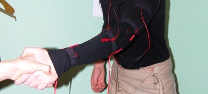

I am working on a wearable input device for controlling telerobots, wearable computers or just regular computers.
The basic idea is that all movement of the upper body should be captured. This can then be used for 1 to 1 control of humanoid robots or simply for organic mouse control. Other options would be software which recognises the activity of the person wearing the input tool and reacts accordingly (--> wearable computing).
I have decided to use a electro-mechanical device for the motion capturing. I am using stretch sensors analogue to key muscles of the human body. So when for example, the biceps is flexed thus moving the arm and shortening its length, the corresponding stretch sensor becomes relaxed. By smart sensor positioning the main body movements should be able to be discreetly recorded. (well. to be honest, I am still a bit lost with how to best record shoulder motion, but I'm confident I'll get it done.)
Anyway. The stretch sensors simply change conductivity according to stretch. I use voltage dividers and my arduino mega for reading the analogue signals and then process the signals in processing.
Here, take a look at the "device":

As a new member of the forum (my first post) I was looking for some interesting projects and then I saw your project. I was directly attracted to it because it resembles my project I want to do. I am also convinced that tele-operated humanoid robots have a great potential and can be used for many things. So I just want to say that you must keep up the good work!
My approach to tele-operation of humanoid robots is more mechanical but I like your idea of using stretch sensors. But for now it is all air and ideas (just bought my arduino and sensors/motors) so I was happy when I discovered your project.
fkeel
share some of your air :-)
I am not 100% happy with my stretch sensor solution - there are lot of little problems which I keep ignoring, hoping they will go away... I have fiddled around with some mechanical solutions but was not really happy with my results (you can find info on this on my blog, if your interested...).
I guess I should stop shying away from inertial measurements ... I'm gonna experiment a bit with accelerometers in the near future...
but yeah: how would you approach this problem? what did you have in mind?

take a look at this here: http://www.animazoo.com/index.php/gypsy-7
the reason why I do not want an exoskeleton is that I want my device to be unobtrusive and subtle. imagine someone wearing a exoskeleton going to a business meeting. might be a bit strange, wouldnt it? instead I want it to be as natural as possible, so that the user doesnt even really feel its there.

@ fkeel: You had some nice results with your mechanical approach (that video you controlling 3 servos is just the same I had in mind for my shoulder joint project). I understand that you would like to keep it 'low-profile'.
My torso vest would consist of a stiff plate in front (chest plate) and a stiff plate on your back (where the mechanical arms would be mounted on) sewn in some rough synthetic textile. The front and rear part are then connected to each other with a shoelace setup. Those mechanical arms would be metal tubes of no more than a centimeter across (where the pivots are bolted on). The arm mount consists of two metal rings that are attached to each other with a metal bar (where you mount the other end of the mechanical arm). It is not very practical for quick usage...
That plastic material is interesting indeed. I can make the stiff parts for the torso vest with this for fast prototyping. It will be trail and error style engineering eheh.
