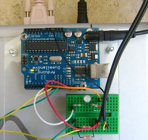

Figure 3 - Arduino Board for testing.
Now testing how to load a bit bigger images. 8)
