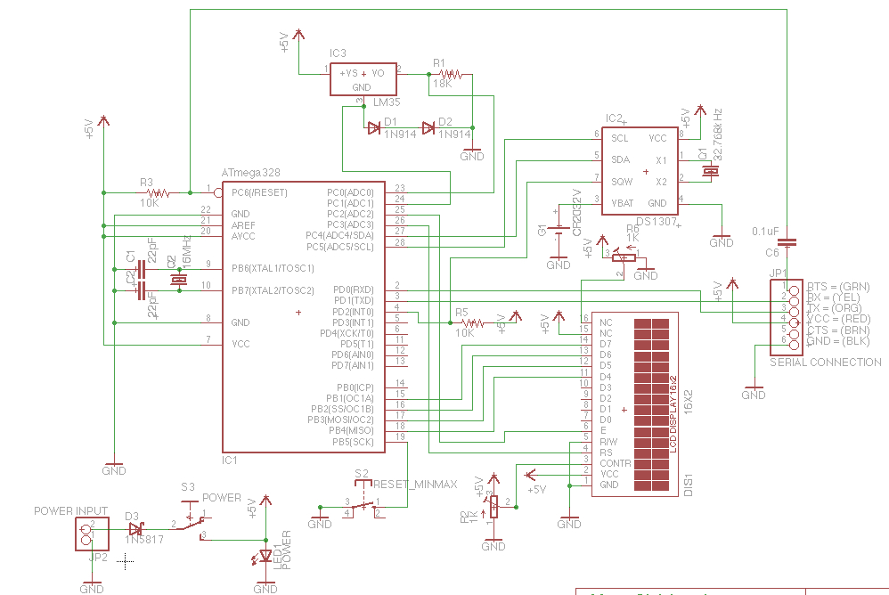

Finally presented it to him along with a laminated version of the schematic I created. He loved it!

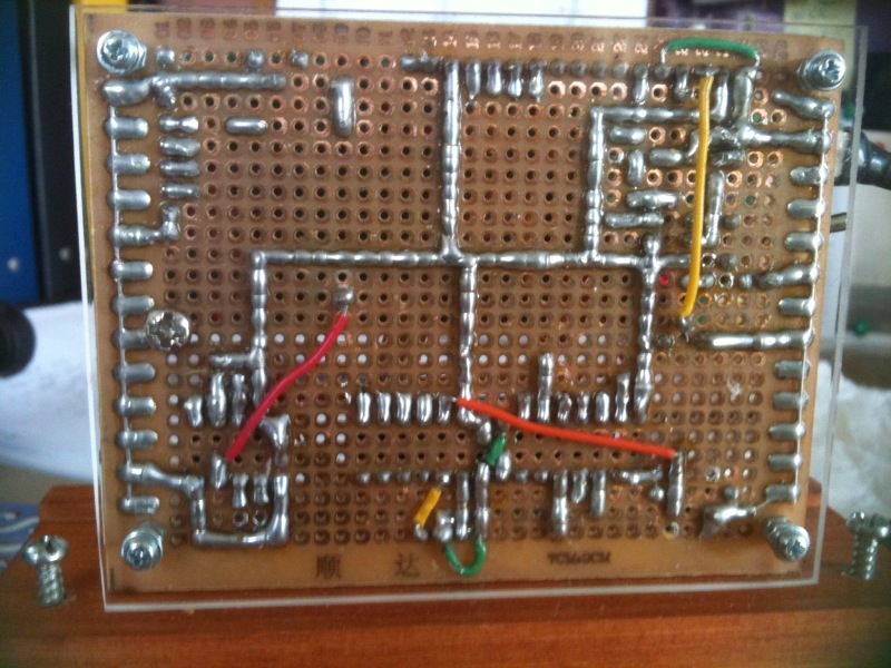

The back on my unit above is visible through perspex as well - I tried to be nice and neat with the point to point soldering. Will post a pic of that plus my schematic later (it's at home).

Back of device shown:
Schematic:
