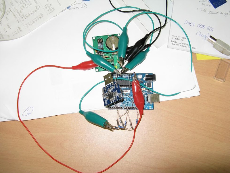

After numerous emails, pulling of hair & re-writes, sirmorris has helped to get my SD card logging dreams up & running. You can get the 'final' sketch here: http://docs.google.com/Doc?id=dqhc6fg_0gmk96kdd. It's certainly not the prettiest sketch, and I can't claim much of it at all as my own work, but it does what I hoped it would (although real-world testing hasn't happened yet).
Here's a photo of my current test setup...
Needs a LOT of work before it's ready for final implementation!! ;D
Please feel free to suggest code improvements/rip my sketch to shreds - I'm no programmer, I've got thick skin, and any help is greatly appreciated!!
