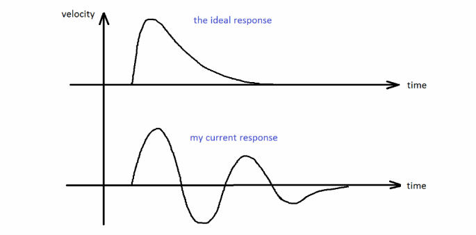

Hi everybody,
This is my first post at Arduino forum and I'd like to say thank you for creating such a great topic.
Just like you, I am interested in two wheel balancing robots. I have built my own one. My robot's construction is similar to this one:
http://www.youtube.com/watch?v=_TXfXoKyMzc&feature=player_embedded
but mine is bigger. I am sorry I cannot provide you with a photo of it right now. I will do so as soon as I can.
When trying to balance the robot, I have a couple of questions as follow:
1. Since the two motors are not perfectly identical, there should be two more PID control loops (apart from the main balance PID loop), one for each motor, to guarantee that the real motor's velocity will strictly follow the set one. In my case, this is actually a problem because when I apply an equal voltage to the two motors, they rotate with different speeds. Especially when one wheel hits an obstacle, say a crack on the ground, and cannot cross it, the robot will rotate around the wheel (in stead of stopping or moving forward). But I didn't see such a problem mentioned before at this thread.
2. Currently I am using the cascaded PID control approach to balance the robot. This approach has been used successfully by Brian Kuschak with his bk-bot:
http://www.bkinnovation.com/bkbot/
My robot can barely balance, in the sense that it doesn't fall, but it oscillates around the equilibrium point with a frequency of 1 to 2 Hz and the oscillation's amplitude is pretty large (the wheel moves back and forth with a travel distance of ~3 inches). I have spent days tuning the PID parameters to reduce this oscillation but so far I have had no improvements. When being pushed, the robot can keep its balance, but it oscillates even more wildly. Please look at this picture to see how my robot responds to a push:
How do you guys think about this? Is this resulted from an improper set of control parameters? If you know a correct procedure for tuning the PID parameters, please show me the way ^^!
3. The third question is about the wheel size. From my observation, it seems that with bigger wheels it is easier to balance, am I correct? Currently my wheels are made from plastic. They are hard and small (their diameter is about 3 inches, which is quite small because my robot is 1.2 metres in height). Will rubber wheels with bigger diameter be better?
Thank you for reading my questions. Any answer would be very appreciated.
I wish you a happy new year ^^

Hi Villa, welcome aboard
Please post a photo of the beast as soon as you can

Quote
Looking at the above diagram, my first idea would be to increase abs(Kd). You need more damping (see post #32). Others will jump with additional ideas.
Also try changing the sign of Kd (mine is negative)
