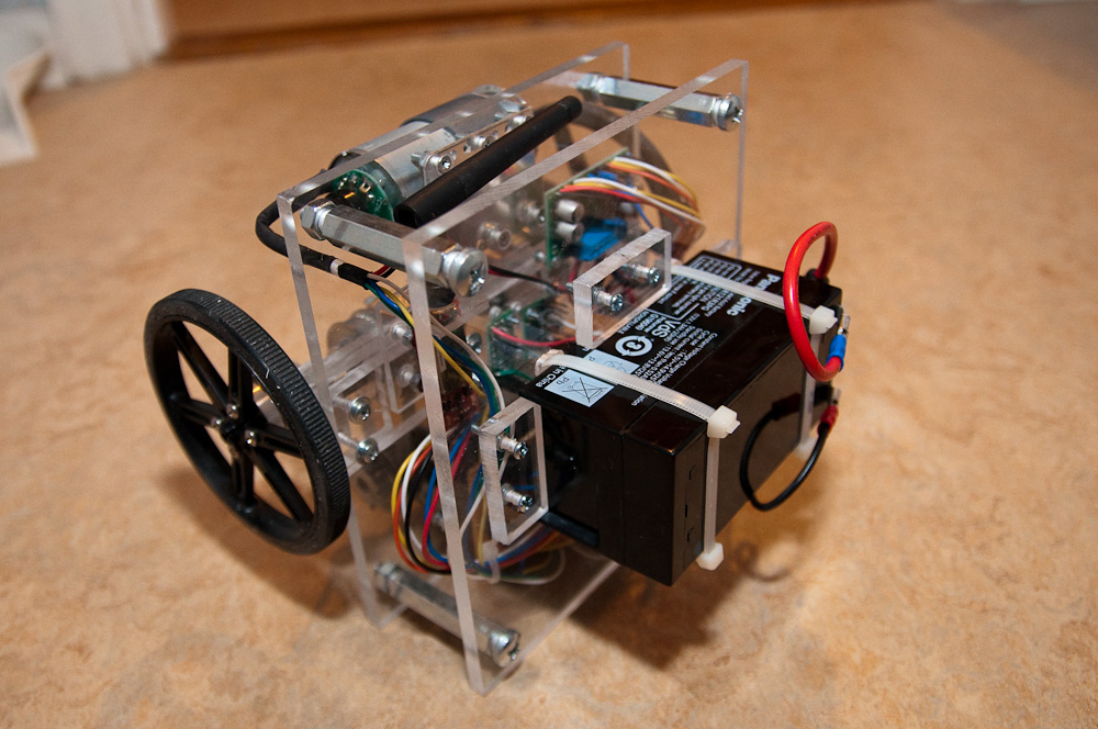

Here is my first try to tune the PID by following your tuning tips (thank you very much for that). I have so far not used the values from the encoders because I want a little moer stability before I do that. Do you have more tips on how to find the best values? I have also tried to google about it but it is hard to follow when it is about other stuff than balancing bots...

@GuzZzt
Looks like a good start, could you take some pictures on the bot and post your construction.. Do you have some instructions and pictures on the bot on some blog or on LMR?

As mentioned by Patrik, please post photos of your setup.
I am curious about your motor positioning, looks like a belt transmission ??

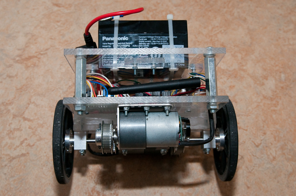

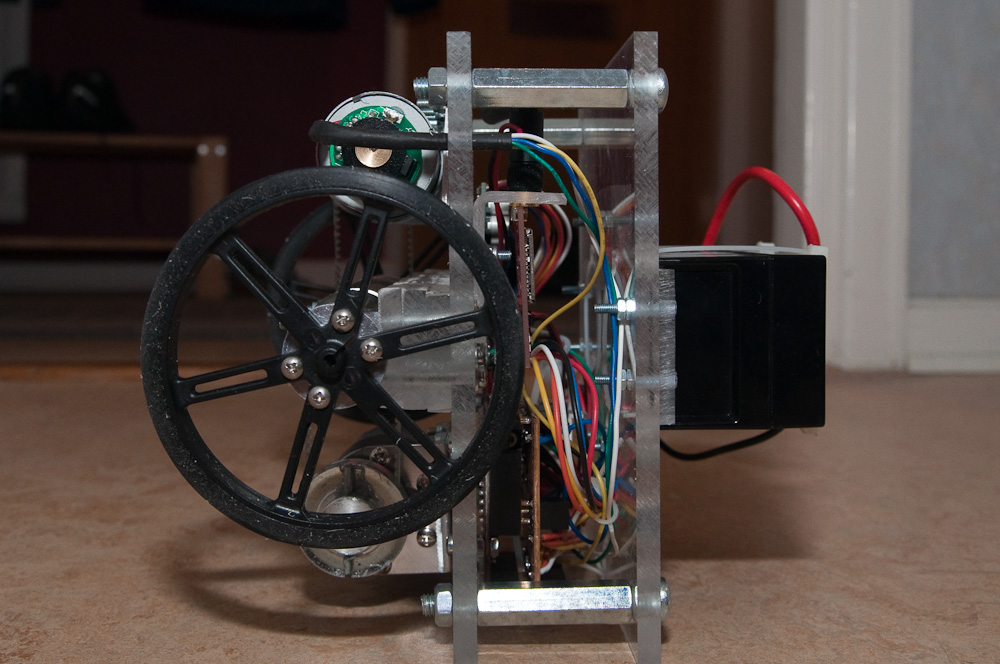

Sure, here are some photos. I plan to write a little more on my site after I'm finished with the main stuff.
I use the same wheels and motors (but only 150RPM) as you do from pololu.com. the belt driving was inspired by the n-bot robot. If you look closely can you see that I in fact don't use an Arduino but a Maple board (an ARM Cortex M3 but the C code is still the same).
Your motors may be a bit slow, you may
 - try the 90mm wheels if you currently mounted the 80mm ones
 - increase the global PID parameter (K)
 - use a smaller pulley on the wheels shafts
Please let us have a link for the belts and pulleys hardware

The mechanics comes from http://www.technobotsonline.com
