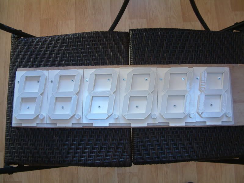

Anyway, here are a few pics of the large LED's I ordered.
I have them temporarily screwed to a piece of plywood just to see what they look like all together. I need to get a few nylon spacers to set them up on and I'm still waiting for my perspex to arrive. I am going to spray the base behind each of the segments in black paint so that it will absorb any light and not reflect back out.
In the meantime I need to sort my new shift registers and get them wired.

Yep, 106 inches by the time winter was over. Luckily I had planned ahead and purhased a snow blower that fall.
This is my front yard, before Friday's storm. Snow is now piled up to the bottom of the mailbox.
I am having the hardest time getting the pause button to do 3 things - start time running after a new turn on or after stop/reset, pause the time, and then unpause the time.  I keep running into the pause/unpause starting one after the other. What I see is the button press being acted upon multiple times; I'm working up a new method to have the next 'state' act on it (start, pause, unpause) and then not start the next state too early.  Not quite there yet tho.
Those digits look monstrous when you get them together!
