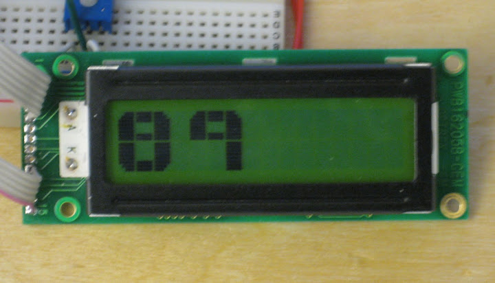

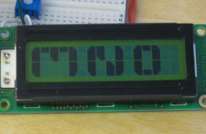

This isn't the first time this has been done. I'm sure the code has allot to be desired but it works. I found this link for a similar project.
http://www.arduino.cc/cgi-bin/yabb2/YaBB.pl?num=1245352653
For one thing i didn't like the style of his numbers. Sure i could change the code used theer but i didn't understand how it all worked. My coding experience is quite limited at this point. So i decided to do my own more simplistic version.
I used the LiquidCrystal library's ability to create a custom character. Its limited to 8 5x8 characters. So i create 8 segments that are used to build large numbers using 2 lines on a 16x2 LCD.
Here is what they look like when put together.
The sketch i built has the numbers counting from 0 to 9 and then it keeps track of the number of program loops on the left in regular text/numbers. Then a reconfigured that sketch so it would display the numbers as seen in the pictures. But i'll post the code to the first one.
Code:
A set of custom made large numbers for a 16x2 LCD using the
LiquidCrystal librabry. Works with displays compatible with the
Hitachi HD44780 driver.
The Cuicuit:
  LCD RS pin to D12
  LCD Enable pin to D11
  LCD D4 pin to D5
  LCD D5 pin to D4
  LCD D6 pin to D3
  LCD D7 pin to D2
  LCD Vee tied to a pot to control brightness
  LCD Vss and R/W tied to ground
  LCD Vcc to +5V
  LCD pin 15 tied to pushbutton for control of backlight
This code has the custum numbers counting from 0 to 9 on
the left hand side of the LCD with a 1 sec delay between
numbers. On the right is a counter tracking the number of
times the program has looped.
Made by Michael Pilcher
2/9/2010

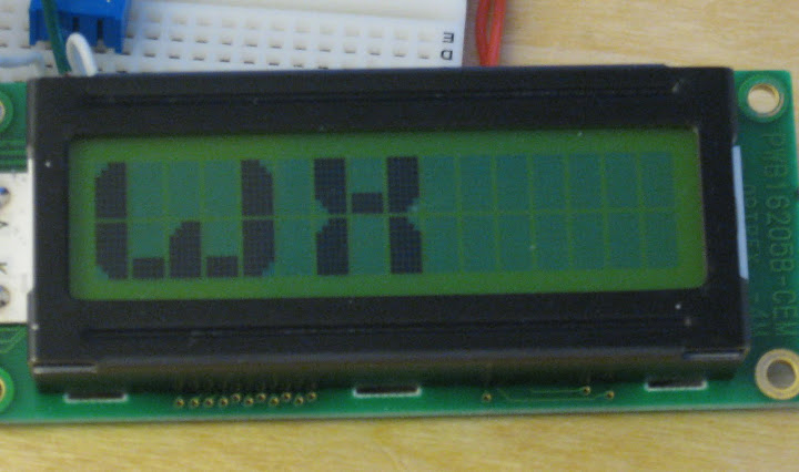

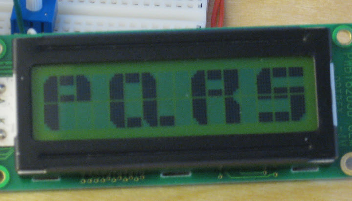

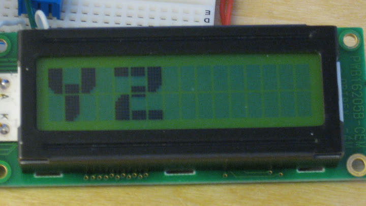

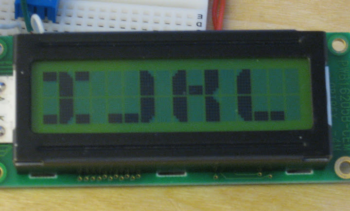

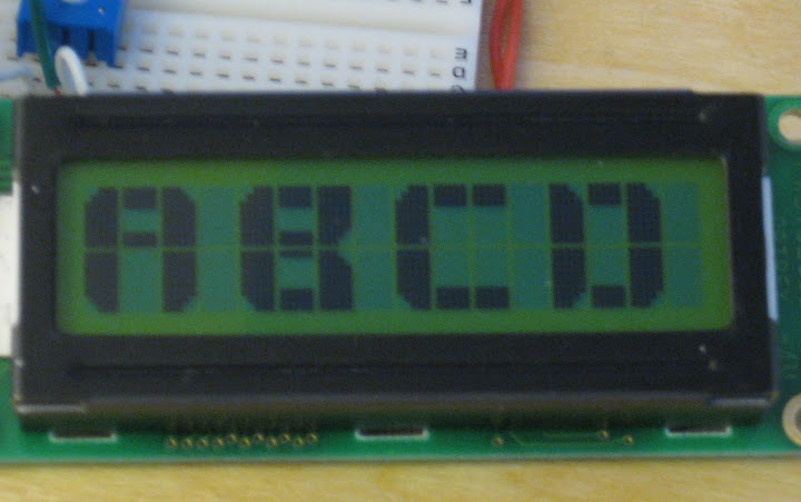

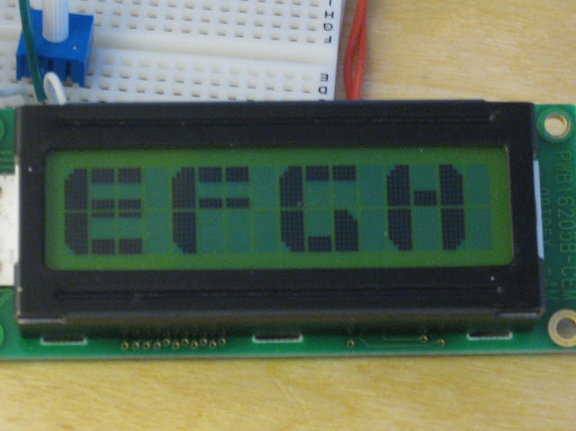

Thanks Bongmaster,
I always do this. I think i have something finalized and i go and make changes. I changed the 7 so that the bottom segment is in the middle. Changed the 5 so that the upper left segment has the curve on the upper left corner. I took the to small bars on the 1 off. I also replaced all of the full bar segments with ones with the corners cut. Now there is a new segment to help the numbers look more balanced. 9 still looks a bit off but you can't win them all.
So i guess i'll use this opportunity to post the code i used for the pictures. Modified as stated above, of course.
Code:

Are you going to do alphanumeric characters? I might have a go if I have the time. I suppose on a 16x2 you don't have enough custom characters to be able to do things like R and Q though...

I've been thinking about that but only having 8 custom characters to work with keeps things limited. If there was a way to flip the character horizontally and vertically then it could be possible.  Then then i would only need 3 custom segments to handle the numbers.
Maybe i need to come up with a way i could redefine the characters on the fly. Like having multiple versions of the setup that can be called too to redefine the available segments.

That is slick Mike - and can see a couple of places I'd like to use that... but would like the letter "F" displayed also in thermometer type displays....  GREAT WORK!
Thanks for posting the info.

Shucks Mike - now you've done gone and done it! Made it so I will have to work on that to get a thermometer displaying these large fonts.  I won't have time just now, but will be saving this thread for study in a week or so.
Thanks for your work.

Here it is. Full code for a large custom alphanumeric display taking up 2 lines of a 16x2 or larger LCD display. The code displays all the letters and numbers.
Code:
 The Cuicuit:
 LCD RS pin to D12
 LCD D4 pin to D5
 LCD D5 pin to D4
 LCD D6 pin to D3
 LCD D7 pin to D2
 LCD Vcc to +5V
 2/9/2010
// include the library
#include <LiquidCrystal.h>
// initialize the interface pins
int x = 0;
// the 8 arrays that form each segment of the custom numbers
byte LT[8] =
  B00111,
  B01111,
  B11111,
  B11111,
  B11111,
  B11111,
  B11111,
  B11111
byte UB[8] =
  B11111,
  B11111,
  B11111,
  B00000,
  B00000,
  B00000,
  B00000,
  B00000
byte RT[8] =
  B11100,
  B11110,
  B11111,
  B11111,
  B11111,
  B11111,
  B11111,
  B11111
byte LL[8] =
  B11111,
  B11111,
  B11111,
  B11111,
  B11111,
  B11111,
  B01111,
  B00111
byte LB[8] =
  B00000,
  B00000,
  B00000,
  B00000,
  B00000,
  B11111,
  B11111,
  B11111
byte LR[8] =
  B11111,
  B11111,
  B11111,
  B11111,
  B11111,
  B11111,
  B11110,
  B11100
byte UMB[8] =
  B11111,
  B11111,
  B11111,
  B00000,
  B00000,
  B00000,
  B11111,
  B11111
byte LMB[8] =
  B11111,
  B00000,
  B00000,
  B00000,
  B00000,
  B11111,
  B11111,
  B11111
  // assignes each segment a write number
  lcd.createChar(0,LT);
  lcd.createChar(1,UB);
  lcd.createChar(2,RT);
  lcd.createChar(3,LL);
  lcd.createChar(4,LB);
  lcd.createChar(5,LR);
  lcd.createChar(6,UMB);
  lcd.createChar(7,LMB);
  // sets the LCD's rows and colums:
  lcd.begin(16, 2);
void custom0O()
{ // uses segments to build the number 0
  lcd.setCursor(x, 0);
  lcd.write(0);
  lcd.write(1);
  lcd.write(2);
  lcd.setCursor(x, 1);
  lcd.write(3);
  lcd.write(4);
  lcd.write(5);
void custom1()
  lcd.setCursor(x,0);
  lcd.write(1);
  lcd.write(2);
  lcd.setCursor(x+1,1);
  lcd.write(5);
void custom2()
  lcd.setCursor(x,0);
  lcd.write(6);
  lcd.write(6);
  lcd.write(2);
  lcd.write(3);
  lcd.write(7);
  lcd.write(7);
void custom3()
  lcd.setCursor(x,0);
  lcd.write(6);
  lcd.write(6);
  lcd.write(2);
  lcd.write(7);
  lcd.write(7);
  lcd.write(5);
void custom4()
  lcd.setCursor(x,0);
  lcd.write(3);
  lcd.write(4);
  lcd.write(2);
  lcd.setCursor(x+2, 1);
  lcd.write(5);
void custom5S()
  lcd.setCursor(x,0);
  lcd.write(0);
  lcd.write(6);
  lcd.write(6);
  lcd.write(7);
  lcd.write(7);
  lcd.write(5);
void custom6()
  lcd.setCursor(x,0);
  lcd.write(0);
  lcd.write(6);
  lcd.write(6);
  lcd.write(3);
  lcd.write(7);
  lcd.write(5);
void custom7()
  lcd.setCursor(x,0);
  lcd.write(1);
  lcd.write(1);
  lcd.write(2);
  lcd.setCursor(x+1, 1);
  lcd.write(0);
void custom8()
  lcd.setCursor(x,0);
  lcd.write(0);
  lcd.write(6);
  lcd.write(2);
  lcd.write(3);
  lcd.write(7);
  lcd.write(5);
void custom9()
  lcd.setCursor(x,0);
  lcd.write(0);
  lcd.write(6);
  lcd.write(2);
  lcd.write(5);
void customA()
  lcd.setCursor(x,0);
  lcd.write(0);
  lcd.write(6);
  lcd.write(2);
  lcd.write(3);
  lcd.print(" ");
  lcd.write(5);
void customB()
  lcd.setCursor(x,0);
  lcd.write(0);
  lcd.write(6);
  lcd.write(5);
  lcd.write(3);
  lcd.write(7);
  lcd.write(2);
void customC()
  lcd.setCursor(x,0);
  lcd.write(0);
  lcd.write(1);
  lcd.write(1);
  lcd.setCursor(x,1);
  lcd.write(3);
  lcd.write(4);
  lcd.write(4);
void customD()
  lcd.write(2);
  lcd.write(1);
  lcd.write(2);
  lcd.write(5);
  lcd.write(4);
  lcd.write(5);
void customE()
  lcd.setCursor(x,0);
  lcd.write(0);
  lcd.write(6);
  lcd.write(6);
  lcd.write(3);
  lcd.write(7);
  lcd.write(7);
void customF()
  lcd.setCursor(x,0);
  lcd.write(0);
  lcd.write(6);
  lcd.write(6);
  lcd.write(3);
void customG()
  lcd.setCursor(x,0);
  lcd.write(0);
  lcd.write(1);
  lcd.write(1);
  lcd.setCursor(x,1);
  lcd.write(3);
  lcd.write(4);
  lcd.write(2);
void customH()
  lcd.setCursor(x,0);
  lcd.write(0);
  lcd.write(4);
  lcd.write(2);
  lcd.write(3);
  lcd.print(" ");
  lcd.write(5);
void customI()
  lcd.setCursor(x,0);
  lcd.write(1);
  lcd.write(2);
  lcd.write(1);
  lcd.setCursor(x,1);
  lcd.write(4);
  lcd.write(5);
  lcd.write(4);
void customJ()
  lcd.setCursor(x+2,0);
  lcd.write(2);
  lcd.setCursor(x,1);
  lcd.write(4);
  lcd.write(4);
  lcd.write(5);
void customK()
  lcd.setCursor(x,0);
  lcd.write(0);
  lcd.write(4);
  lcd.write(5);
  lcd.setCursor(x,1);
  lcd.write(3);
  lcd.print(" ");
  lcd.write(2);
void customL()
  lcd.setCursor(x,0);
  lcd.write(0);
  lcd.setCursor(x,1);
  lcd.write(3);
  lcd.write(4);
  lcd.write(4);
void customM()
  lcd.setCursor(x,0);
  lcd.write(0);
  lcd.write(1);
  lcd.write(3);
  lcd.write(1);
  lcd.write(2);
  lcd.setCursor(x,1);
  lcd.write(3);
  lcd.print("   ");
  lcd.write(5);
void customN()
  lcd.setCursor(x,0);
  lcd.write(0);
  lcd.write(3);
  lcd.print(" ");
  lcd.write(2);
  lcd.setCursor(x,1);
  lcd.write(3);
  lcd.print(" ");
  lcd.write(2);
  lcd.write(5);
void customP()
  lcd.setCursor(x,0);
  lcd.write(0);
  lcd.write(6);
  lcd.write(2);
  lcd.write(3);
void customQ()
  lcd.setCursor(x,0);
  lcd.write(0);
  lcd.write(1);
  lcd.write(2);
  lcd.write(3);
  lcd.write(4);
  lcd.write(3);
  lcd.write(4);
void customR()
  lcd.setCursor(x,0);
  lcd.write(0);
  lcd.write(6);
  lcd.write(5);
  lcd.setCursor(x,1);
  lcd.write(3);
  lcd.print(" ");
  lcd.write(2);
void customT()
  lcd.setCursor(x,0);
  lcd.write(1);
  lcd.write(2);
  lcd.write(1);
  lcd.setCursor(x,1);
  lcd.print(" ");
  lcd.write(5);
void customU()
  lcd.write(0);
  lcd.print(" ");
  lcd.write(2);
  lcd.write(3);
  lcd.write(4);
  lcd.write(5);
void customV()
  lcd.write(3);
  lcd.print("  ");
  lcd.write(5);
  lcd.write(3);
  lcd.write(5);
void customW()
  lcd.setCursor(x,0);
  lcd.write(0);
  lcd.print("   ");
  lcd.write(2);
  lcd.setCursor(x,1);
  lcd.write(3);
  lcd.write(4);
  lcd.write(0);
  lcd.write(4);
  lcd.write(5);
void customX()
  lcd.setCursor(x,0);
  lcd.write(3);
  lcd.write(4);
  lcd.write(5);
  lcd.setCursor(x,1);
  lcd.write(0);
  lcd.print(" ");
  lcd.write(2);
void customY()
  lcd.setCursor(x,0);
  lcd.write(3);
  lcd.write(4);
  lcd.write(5);
  lcd.write(5);
void customZ()
  lcd.setCursor(x,0);
  lcd.write(1);
  lcd.write(6);
  lcd.write(5);
  lcd.write(0);
  lcd.write(7);
  lcd.write(4);
  customA();
  x = x + 4;
  customB();
  x = x + 4;
  customC();
  x = x + 4;
  customD();
  delay(4000);  // delay 4 seconds
  lcd.clear();  // clears the display
  x = 0;  // resets x to 0
  customE();
  x = x + 4;
  customF();
  x = x + 4;
  customG();
  x = x + 4;
  customH();
  customI();
  x = x + 4;
  customJ();
  x = x + 4;
  customK();
  x = x + 4;
  customL();
  delay(4000);
  lcd.clear();
  x = 0;
  customM();
  x = x + 6;
  customN();
  x = x + 5;
  custom0O();
  delay(4000);
  lcd.clear();
  x = 0;
  customP();
  x = x + 4;
  customQ();
  x = x + 5;
  customR();
  x = x + 4;
  custom5S();
  delay(4000);
  lcd.clear();
  x = 0;
  customT();
  x = x + 4;
  customU();
  x = x + 4;
  customV();
  delay(4000);
  lcd.clear();
  x = 0;
  customW();
  x = x + 6;
  customX();
  delay(4000);
  lcd.clear();
  x = 0;
  customY();
  x = x + 4;
  customZ();
  delay(4000);
  lcd.clear();
  x = 0;
  custom0O();    // displays custom 0 on the LCD
  x = x + 4;    // sifts cursor over 4 columns
  custom1();
  x = x + 4;
  custom2();
  x = x + 4;
  custom3();
  delay(4000);
  lcd.clear();
  x = 0;
  custom4();
  x = x + 4;
  custom5S();
  x = x + 4;
  custom6();
  x = x + 4;
  custom7();
  delay(4000);
  lcd.clear();
  x = 0;
  custom8();
  x = x + 4;
  custom9();
  delay(4000);
  lcd.clear();
  x = 0;
Enjoy!

Took these kind of quick before heading to work but here is the letters for you.

They look nice.
Quote
You can redefine on the fly can you not. Call a code section to redifine and it should be simple enough.
