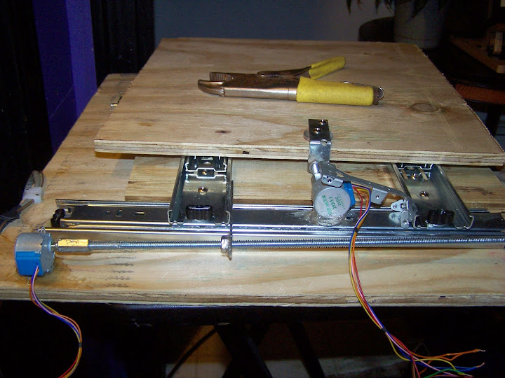

Moving the project over here from Bar Sport... and it's good to be tinkering again!
Put as simply as possible, I am attempting to build a 3D router which will be used to cut images into wood.  Given that wood is the intended material, tolerances are important, but the material itself lends itself to tolerances in the tenths of inches and not thousandths, as in fine metal milling.  Since the required tolerances are rather easy, I am cautiously optimistic that this can be pulled off in a crude manner, with the help of your friend and mine, Arduino.
My design is very simple- a horizontal xy table on ball bearing rails, driven by a screw drive and a stepper motor per axis.   The vertical dimension and router will be a Dremel type tool, with a screw/stepper to control the plunge depth on the otherwise stationary (in x and y) cutting head.  A key portion of the project is the rails the platform rides on, which are typically quite expensive.. until I was absent-mindedly watching a well-made kitchen drawer close.  My design relies upon two sets of ball bearing drawer glides being used as these rails.  So far, it's working stunningly.
My goal is to make it for under a hundred dollars, excluding the Dremel.  Fifteen hours from the first concept sketch,  I have a working prototype of the xy routing table.. With a cost still around fifty bucks, including the BoArduino (just a breadboard-friendly Arduino, a favorite variant of mine), the steppers and the controller circuitry... it seems that the hundred dollar goal is very possible.
Please note that if you are reading this and want to make one, this is something there's no kit for.  You need to be able to work things out yourself and come up with solutions for the problems you run into.  My goal is to inspire others to come up with their own designs, like I did- I wanted a machine I can't afford.. so I am foolish enough to believe that I can just build one myself.  Even if this device succeeds, don't kid yourself-  this is FAR from a well-engineered device, it will break, and there's likely to be many issues.  That being said.. I'm having a ball with this, and to be honest it's pretty cheap and not THAT hard.  Epoxy and duct tape are required !

Image taken while XY table running test code... VERY slow but it works!

Adding Images, Text to follow...
Here's a breakdown of the parts and shots of the project so far.  Epoxy putty has been used to reinforce the mounting of the motors as well as several other points where mechanical stress seems to be more likely to be a problem for liquid-type epoxies.

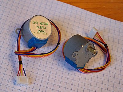

Two Gear Reduced 5v Stepper Motors
Movement is driven by these stepper motors, which can be bought for around two dollars each online.  They are mass-produced for applications like operating valves and air vanes in air conditioners.  They are very slow, but due to the 1/64 gear reduction, they have tremendous torque,especially considering their tiny current draw.
I expect that the speed of the motors may make me replace them with something more robust at some point.  The table movement can be done in tiny increments too small to actually move the table beyond the play in gear train, but at top speed it travels so slowly it takes five minutes to move the work surface through it's roughly 12" travel range.
Ball Bearing Rails, Base, and Work Platform
Two sets of ball bearing drawer slides carry the work platform, which is moved in the x and y axises by a bracket connected to the drive screws (which in turn are connected to the steppers, one per axis) allowing for reasonably accurate movement.  These were gotten from a home supply store as "14 Inch Side Mount Ball Bearing Drawer Slides", two per package for about twelve dollars.  We need two sets.
In use, a third axis, consisting of the router (a Dremel type tool) on it's own drive screw will provide the routing depth, the z axis.  Other than depth, the router remains stationary and the work platform along with the routed material is moved relative to the cutting head of the routing tool.
The material I have used is 3/8" standard plywood, purchased from a cull bin.  If you don't have enough, buy a half sheet and keep the scraps for other projects.  If you look closely, you will see that the plywood cuts are sloppy and not even particularly straight.  It's the rails which make them move properly, not being perfectly square in shape!

@focalist: You've inspired me to at least purchase the motors and drivers; I found a chinese supplier on ebay who was selling the motors and ULN2003 driver boards for about $8.00 each; easier and faster than me soldering 'em up. Not sure when I'll get around to using them (someday, though), but thought I would go ahead and get them while they still existed. I'm following your bodging progress; can't wait to see what comes next!

You won't regret buying the motors.  I've got two of them as the direct-driven wheel motors on a robotic car thingie, it can be "driven" with incredible accuracy.  I have also replaced the recycled ones I used to make the wall plotter with a pair of them.  Their only real drawback of them is their speed.. but I can deal with it most cases, given the cheap-as-dirt price on them.  You are going to end up buying a box of 'em from a wholesaler.. I paid less than twenty dollars for a box of eight including shipping, and am thinking about getting more.  They are remarkably well made for their cost.  The speed is due to the 1/64 gear reduction, so there's not a lot that can be done speedwise unless you do external gears or what have you.  Paired with a ULN2003A premade board, all you need is a couple of jumpers to the control pins.
There is one quirk with them- if using standard Arduino stepper libs, the winding connections need to be declared in 1-3-2-4 sequence, rather than the expected 1-2-3-4.  There's a few threads on this.  Outside of that, a stepper with 2048 steps per revolution is amazingly useful...

I have personally built a cnc router and I think you may want to get some more threads per inch.  The 1/4 inch rod is probably appealing, but the 20 TPI will cause issues with travel times and weak torque on your motors.  The faster the stepper motor turns, the lower the torque it can provide.  I am currently looking into changing my rods to a more coarse thread for faster travel.
All of that being said, the goal is to keep the project under $100, so I understand if speed and torque are not of prime concern.

Well, the speed is an issue, but because the steppers are internally geared at a 1:64 ratio the torque is not really an issue per se.  If I switch them over to a direct drive to the screw standard stepper, I would need to use something with appreciably more ungeared torque.
Having to deal with a furnace issue, so not had a chance to measure the actual rate of travel, but suffice to say that it is in the one to two inches per MINUTE range.. But since it's a gear reduced motor feeding that 20  TPI, the torque is plenty to effectively rip the assembly apart if you ignore position and start  backfeeding the screw against the limits of the slides.  Limit switches are needed.. If it can break two ton bind epoxy, I think it may be okay for wood routing.
