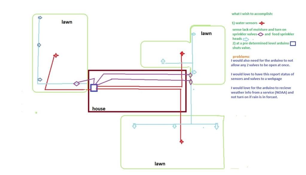

I am very new to arduino and electronics in general. I am starting out and really enjoying it.
I want, for my very first project, to accomlpish the task of watering my lawn.
I attached a drawing (hope I attached it right), and it is a basic Idea of what I would like to accomplish.
I am looking for any helpful info on this project, and would be very grateful.
you prob. saw a few of my other posts on this topic and allot of cool people have helped me out.
I just wanted to re-post it in one central location.

so, I have wasted a week or 2 trying to figure out and build different sensors. \
Understanding that they are not the best choice, I am going to go with the gypsm blocks anyway.
mainly because they are the only one that I am recieving a reading high enough to set on/off limits to send a signal
to the valve. and the vegetronix are like $40 a pop.
the point I am at now is trying to figure out how to hook up 2 sensors to the arduino and get a serial read on them,
so that I can compare the 2 readings.
the 2 sensors are right now in my basement in a container of soil.
but I can only hook up 1 at a time.
any help?

Well your half way there, to read two sensors you have to wire them to two different analog input pins:

So i guess now i need to start figuring out how to send a signal to and activate a sprinkler valve.
I believe they are 24volt. Sooooooo if the arduino puts out 5volts how do i operate these valves?
I have read some on this but i am not sure.
So, how do you operate higher voltage devices with the arduino?
retrolefty
#7
Feb 08, 2012, 02:50 am Last Edit: Feb 08, 2012, 02:52 am by retrolefty Reason: 1
You drive either transistors or relays from the arduino output pins and they do the 24 volt switching of the valves. There should be many examples of switching circuits in the arduino playground section under outputs. First thing is you have to careful understand the ratings on the sprinkler valves (solenoid valves really), what is there voltage rating?, AC or DC?, and what amount of current do they draw with turned on? This current value is important for sizing the transistor switches and to determine how much current your external sprinkler power supply should be able to supply in total for all the sprinklers. Say if each sprinkler requires 100ma or current and you have 4 sprinklers, that is 400ma total if all are turned on at once, and you should probably size to power supply to 200% of that so maybe 1 amp capacity for the supply.
Keep reading. Here is an example of a arduino using a transistor to active a relay coil, you can just replace the relay coil (K1) with your sprinkler solenoid coil and it works the same. This assumes your sprinklers are DC operated, if AC operated you have to use an intermediate relay and use it's contacts to switch the AC current on and off to the sprinkler coil, or use a SSR (solid state relays) which is simpler to wire to a arduino but do cost a little more then relays in most cases.  http://arduino.cc/playground/uploads/Main/relays.pdf

openbahr
Great info. Thanks so much again Lefty.
To step back for a moment, do you think that the length of the wires going to the sensors will be a problem?
retrolefty
#9
Feb 08, 2012, 03:08 am Last Edit: Feb 08, 2012, 03:09 am by retrolefty Reason: 1
Depends on the sensor electrical design, noise picked up on long wire runs could come across as noisy readings, however you are averaging 15 readings so that is acting like a low pass filter. I own an oscilloscope, so I would just hook it up at the arduino side and see how much noise was on the line. But most here don't have a scope so you just are going to have to look at the readings you get and see if they seem stable enough or not. Sometimes using shielded cable can help, grounding the shield to an arduino ground pin and left floating at the sensor end.
Now on the output wiring depending on the current draw for the sprinklers long runs can cause voltage drops but can be compensated for by using larger gauge wire size.
