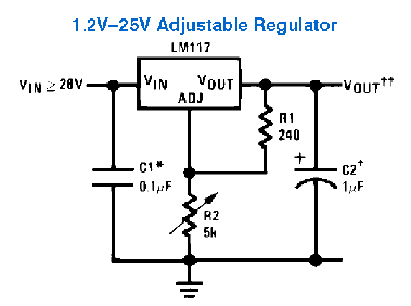

How about using a LM317 or LM338...
I am only afraid of the R1 here, As soon as it gets disconnected the output voltage gets equal to the input voltage... :(
This is how one of my Atmega got fried up...:P

Several things here do not make sense to me:
1. Many, many 7805s get used with ATmega328s without trouble.
2. I'm not clear whether you are actually measuring the alleged ripple, or are making an assumption based on something seen on the analog inputs, please clarify that.
3. The ripple rejection specs for 7805s and LM317s are fairly similar.
4. I don't know why an LM317 configured to output 5V would run significantly hotter than a 7805, all other things being equal.
Have you tried a different 7805? The fact that a 78L05 works makes me wonder if you have a bad part.
Please post your power supply circuit, and describe the source of the input voltage.
How much current does the load pull? If it's just a 328 and a couple LEDs, it can hardly be more than 50mA, yes?
